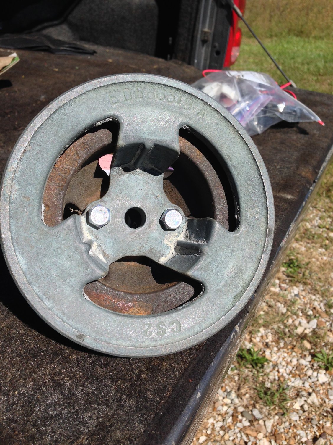

Went out to the shop and looked at my add on.
Not sure you could install the washer!
