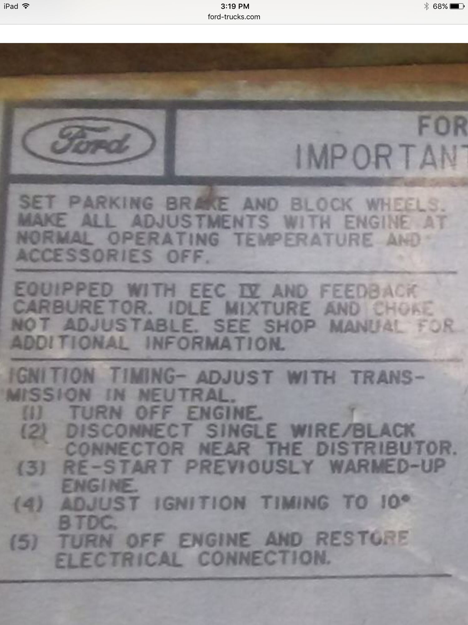

Old Sep 11, 2016 | 09:16 AM
Brian0819's Avatar
Brian0819
Joined: Sep 2016
Posts: 18
Old Sep 11, 2016 | 09:47 AM

The label says it should have a feedback carb. Do you have electrical connections to your carb? If not it isn't a feedback carb. Perhaps someone put the right tag on the wrong carb. But w/o wires the computer is going to be UPSET and the timing will be locked.

I wonder if that carb on there right now came from a JY or some such, that's a good thought that maybe somebody transferred over the ID tag.

Hm... The only electrical going to the carb is for the tps and the choke. Spent hours yesterday just trying to work on my brakes. Replaced a couple lines. But the bleeder screws took way to much time to get out. Didnt even get to bleed them.

So if i am supposed to have a feedback carb, do i have to get a new carb or is ghere another solution?

It hasn't sunk in yet I see. You have a serious setup problem with your engine. If you want to delay working on it, it will probably run, but not very good. You have two choices;
Get the correct carb, hook all the wires and hoses back up as original, and really learn how this electronic carb system works so you can work on it. Or
Change the distributor out with a older style and older style ignition module. Then you won't need the computer to work.

Changing the distributor is by FAR the best way to go. The feedback system was complex and difficult to maintain for those that know what they are doing. The DS-II system is very simple and reliable.
As for how, go read post #9.

Wait a minute... Post #1 shows one of the carb's solenoids! Maybe he can just pull the codes and go from there (Gary, it's really not that hard, but trying to teach people this stuff on a forum like this is difficult):

If that is on the carb, then it must be a feedback. So, maybe things aren't as bad as I thought.
I'd try to pull codes, like you suggest, and check that the timing is changing. If the timing is changing then it isn't in limp-home mode.
