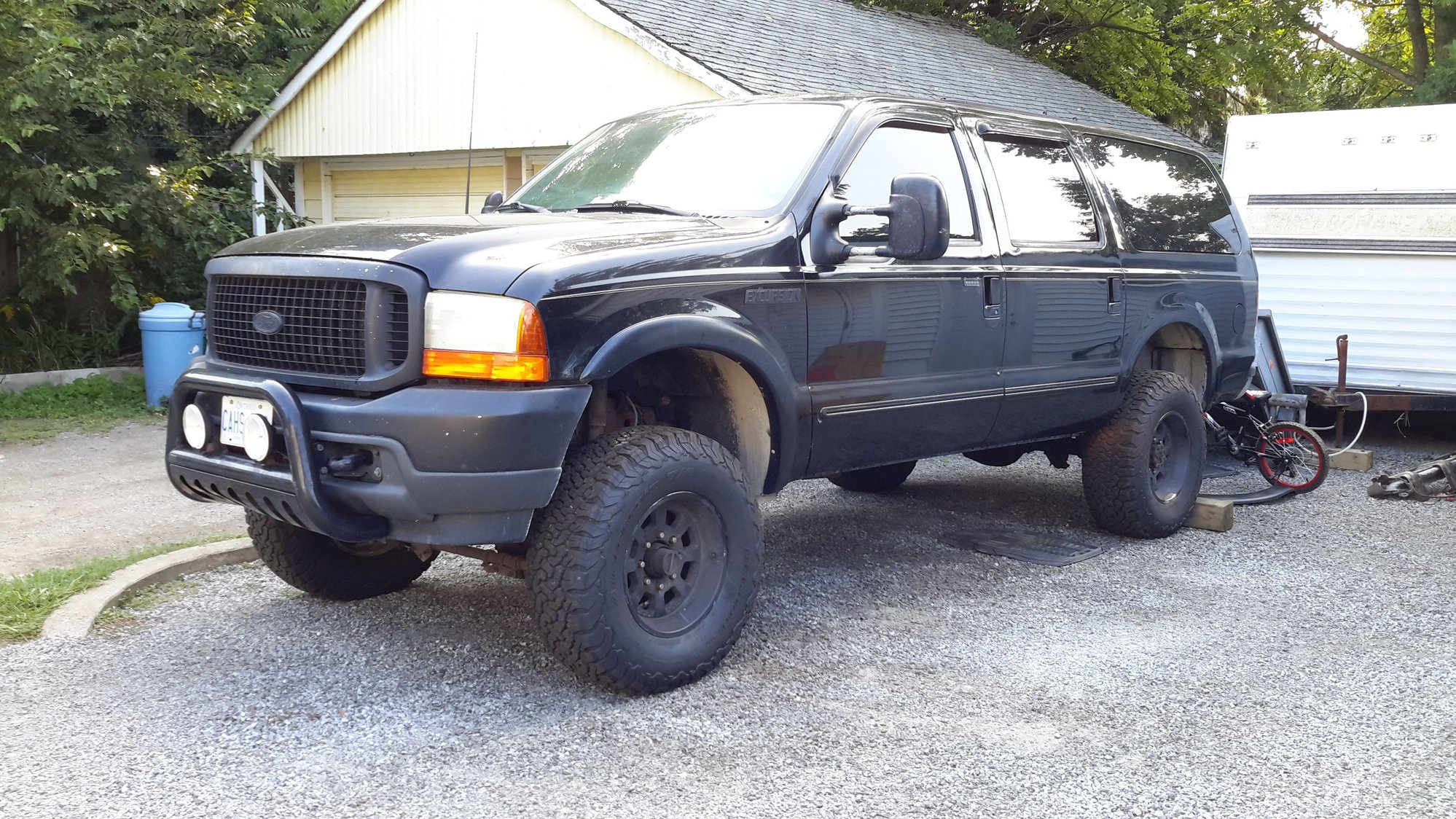

So I bought this money pit, sorry, I mean Excursion..lol Anyway the tires were 315/70/17 (35's) They were trashed, so I just bought a new set of BFG Ko2's.
Anyway, Now that I am having a better look at the lift, I am thinking it looks like a bit of a hack job. I want this to be safe, as I will be pulling our camper with it. I am getting very close to having too much money in this now, so I need to keep costs down..
What are my options? Here is what I am thinking:
-Sell tires, remove the lift, return to stock
-Buy a proper 4" lift (will the 35"s work with a 4"?)
- Some sort of V and B with small lift hybrid
or ?
Thanks !

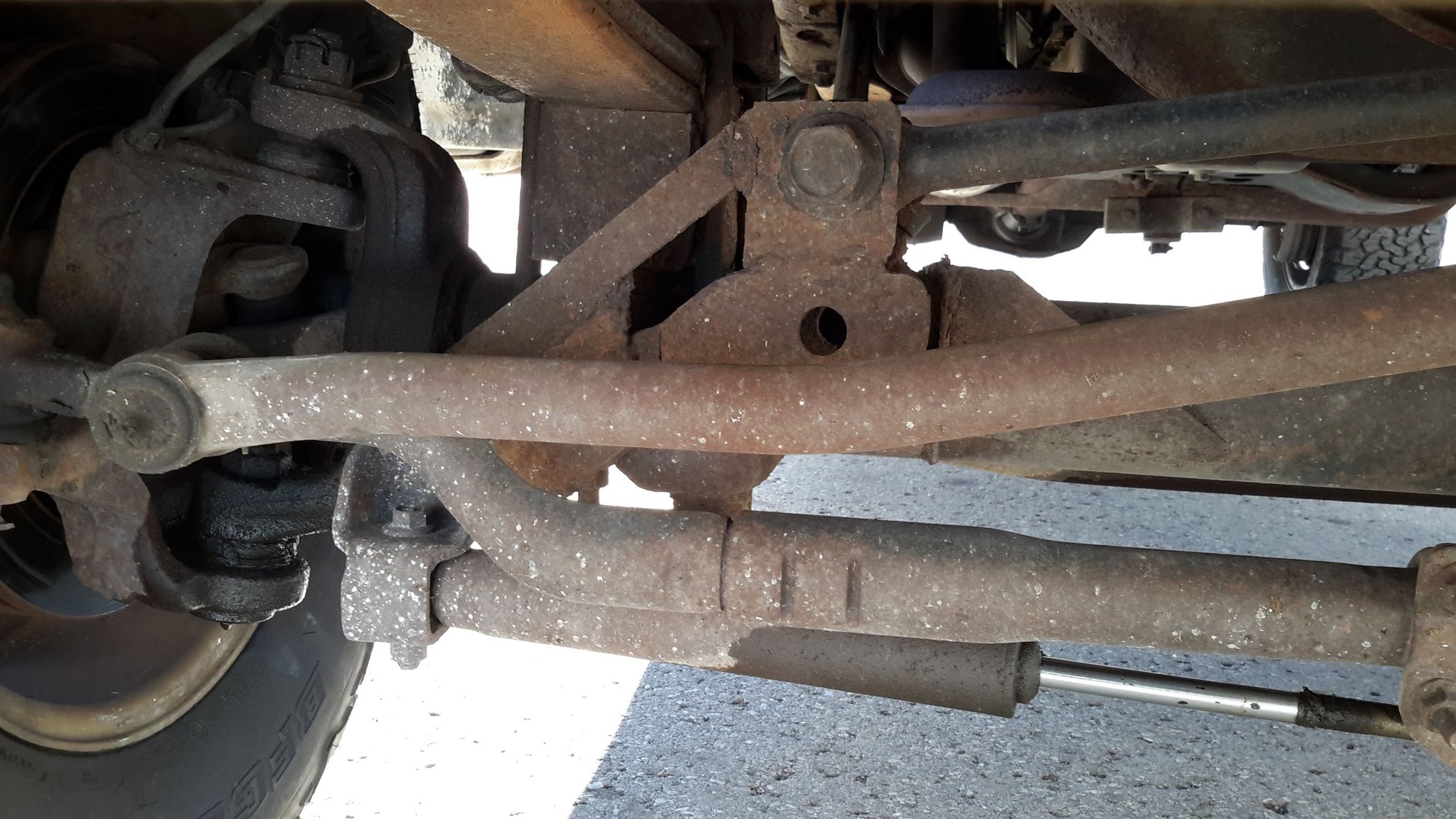

Ok, first the front.

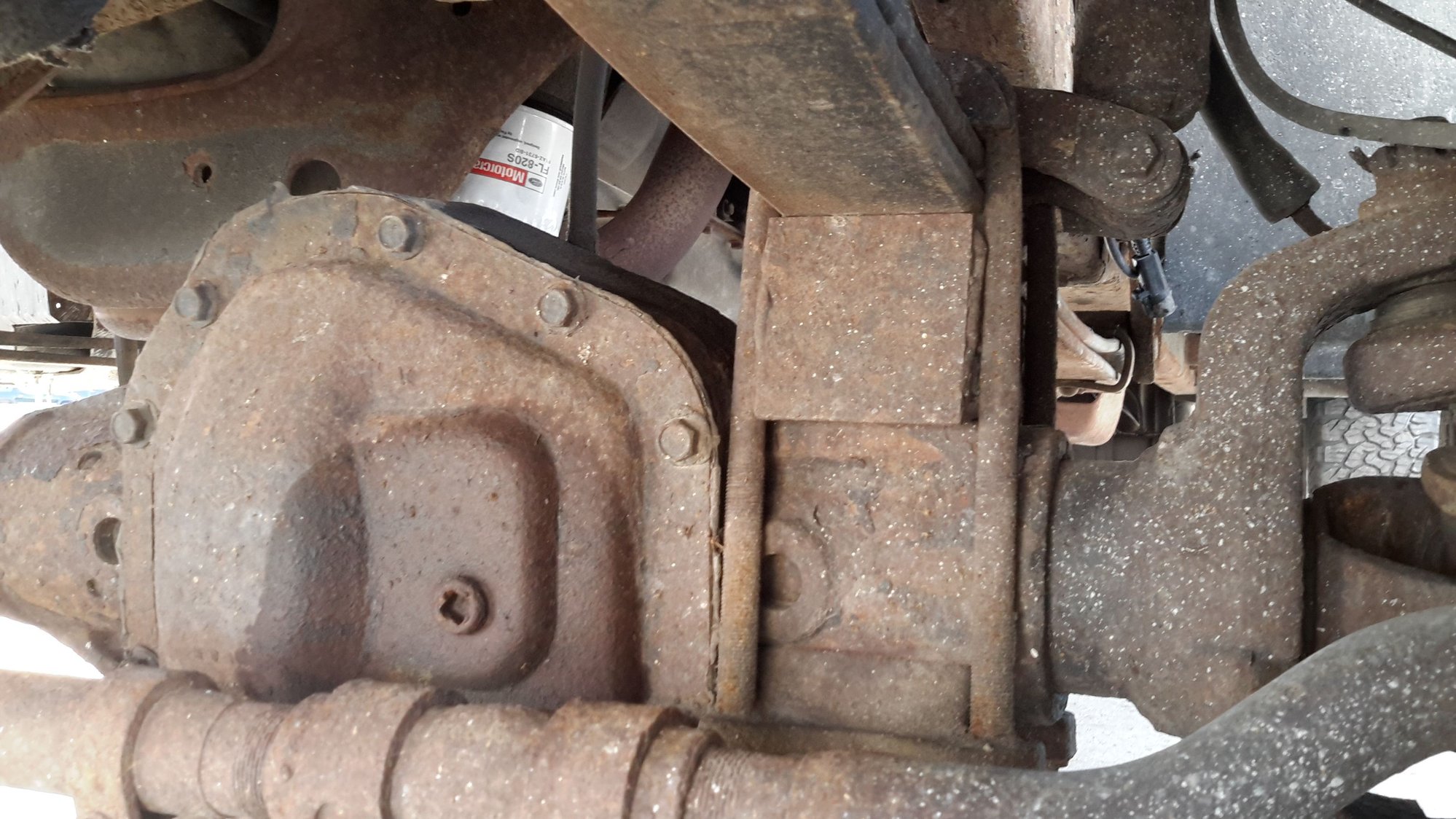

-first off, someone has used blocks, I understand blocks are a no no on the front.
-second, look at the track bar. Chassis end is shimmed, and axle end appears to be raised. To be fair, lots of gussets there. Looks solid though.

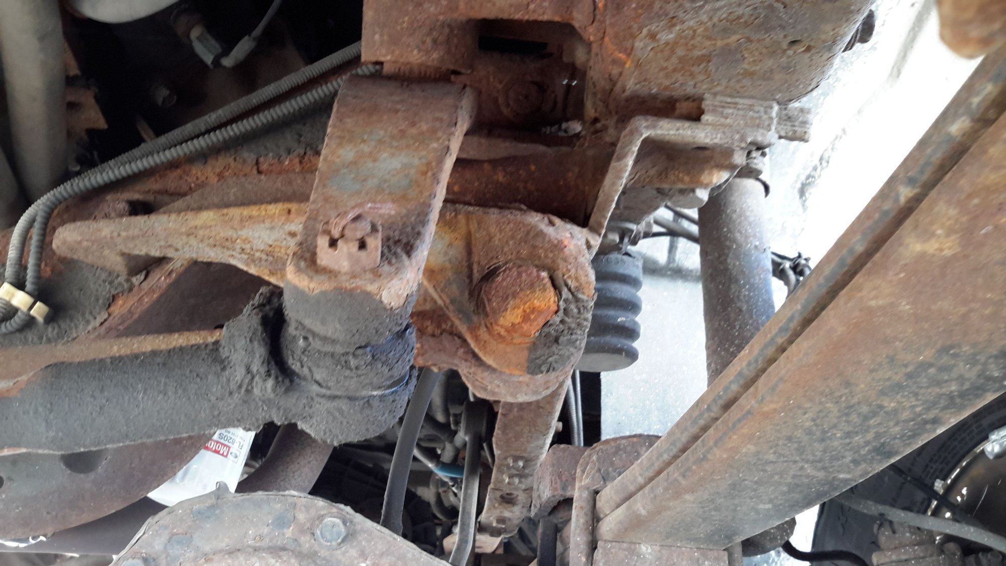

Rear, blocks, and leaf spring parts?
-hmmm

I guess it works as it looks like it has been there a while. I agree with you, it appears to be home made job. Front blocks are a no-no. The rear doesn't look much better. That much torque, seems like axle wrap would have already been an issue. At least you have enough sense to get under your own vehicle and look. That is becoming less and less common.

Someone did quite the hack job under there. Wow.
