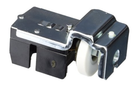

the parts store is pretty proud of their stuff. I found this, but where does the push pull **** go?
The **** and shaft is a one piece assembly, fits into the hole at the front of the switch.

D3AZ-11654-A .. Headlamp Switch (Motorcraft SW-1226) / Available from Ford & auto parts stores.
1978/79 F100/350, Bronco & Econoline // 1973/74 LTD / 1973/76 Torino/Ranchero / 1973/77 Maverick / 1974/78 Mustang II / 1974/79 Pinto / 1975/78 LTD without hidden headlamps / 1975/79 Granada.
