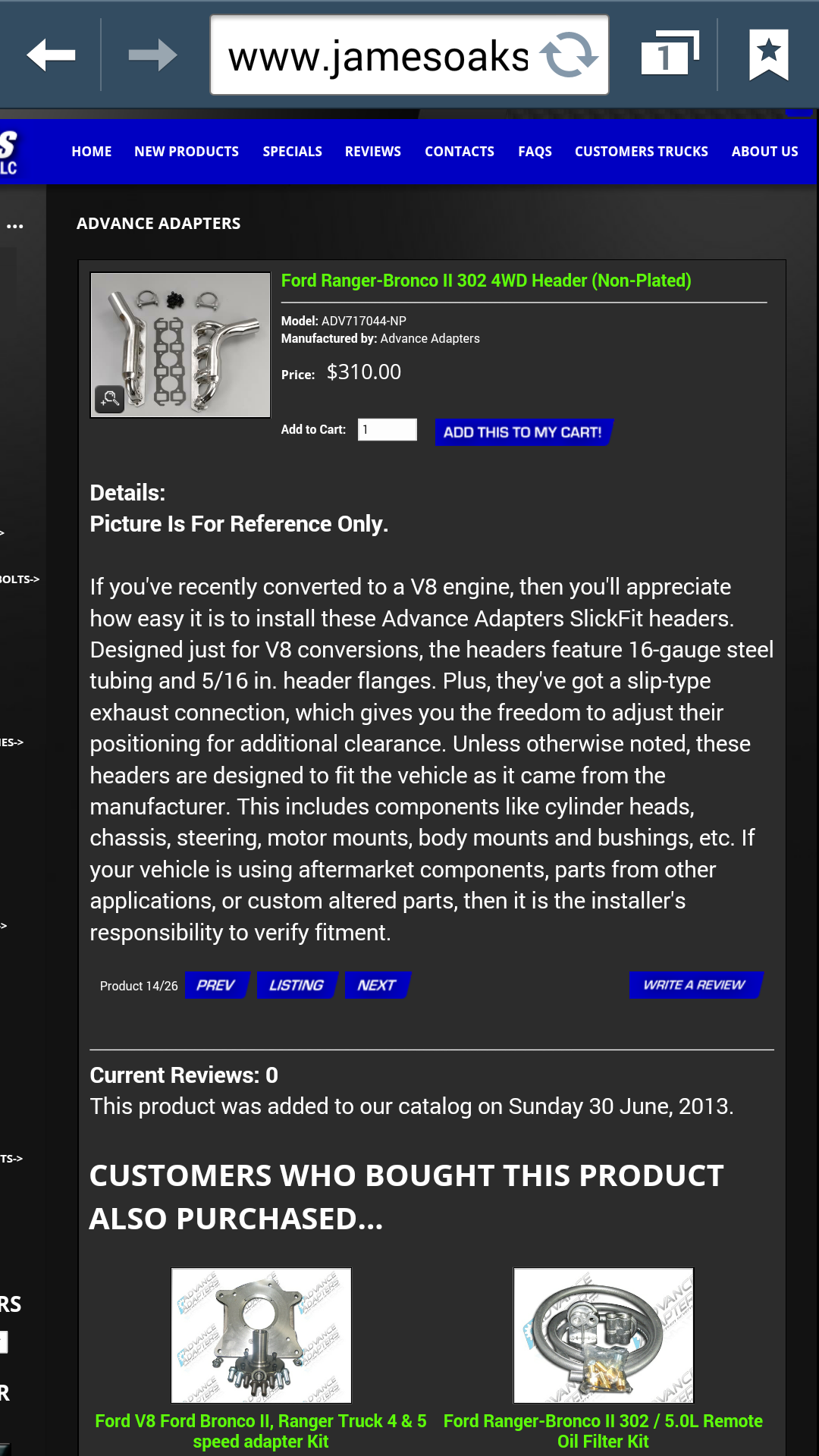

Hey everybody, 1978 f150, i have a 302 with a np435-np205 setup, want to add some headers (if possible). I have dual exhaust currently with stock manifolds. Both tubes run along right frame rail then straight out the back. I have a 3 inch body lift as well. not sure how much info you need, but would like to know what my options are.

I've had these on my truck, 4×4 4speed, for over 10 years. Not the most free flowing but better than stock manifolds and they've held up really well

I'm 99% sure these will work as well. A friend of mine has them on a 2wd 4speed truck and they seem to end in almost the same locations
