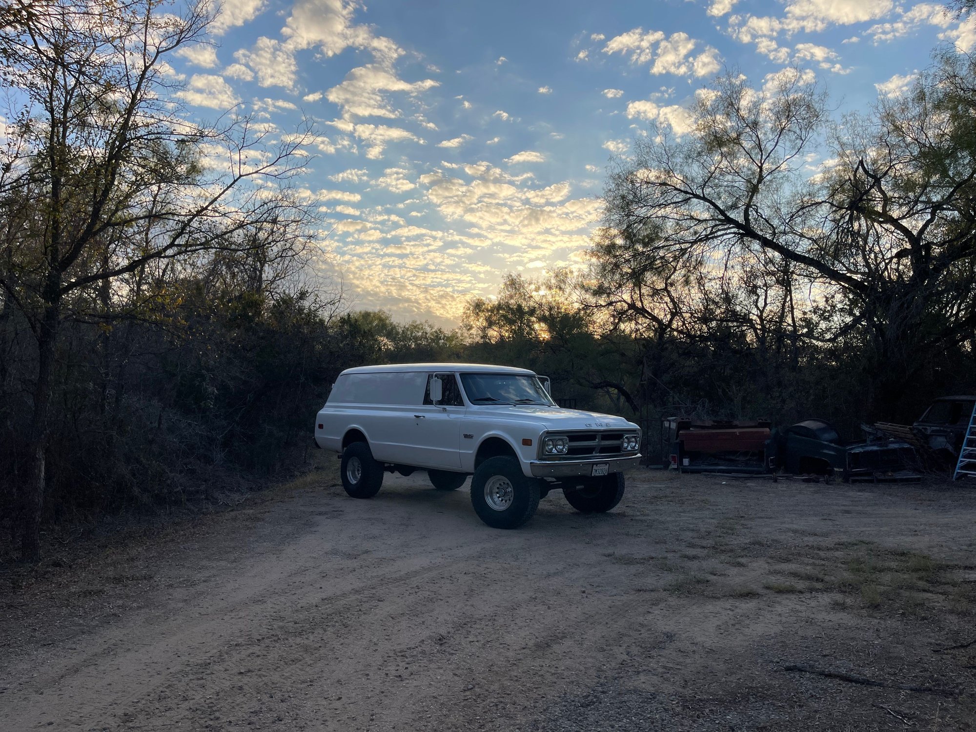

Dang, if you were closer Charlie I’d head over to your place and ask (pay) you to do it for me,
at the risk of being run outa here I’ll post a pic. Now keep in mind, I own and have owned more Fords than I can count but I also love old Chevys/GMC
