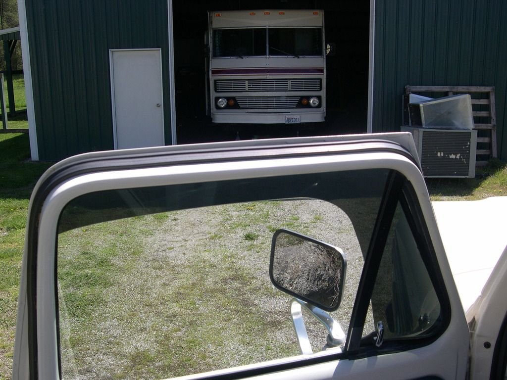

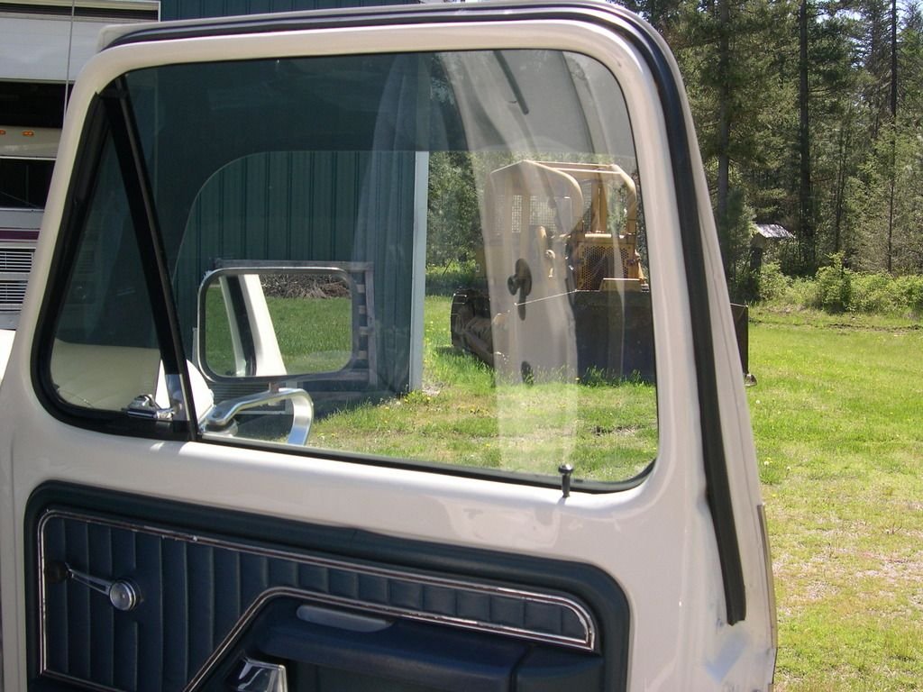

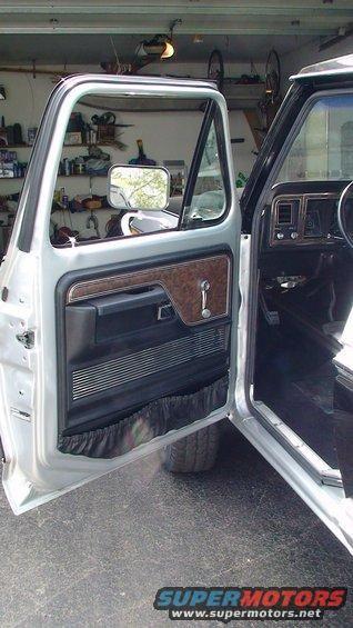

Hey people! I am replacing the weather stripping on my 78' ford and was wondering where the exact placement of the strip on the door is. It appears that they did not have this piece on from the factory but you can get it from LMC Truck. it goes on the door itself, i know that much but I dont know where exactly or how it should be placed. If someone could give a little insite on this or post a pic that would be great, thanks in advance!

Here are some pics of this strip. Hope this helps.

Thanks for the pics! That is exactly what I needed. You have a very nice truck there! I am still in the process of restoring mine so I may post pics of it later when i get it done but I am painting mine white too. but I dont think my inside door panels cost as much as yours.

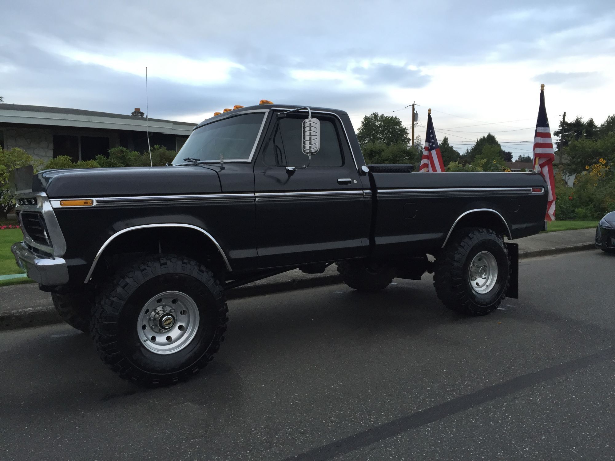

Awesome. I just grabbed those pics from another thread haha! Here are my babies. Goodluck on the truck!

2) D8TZ-1020518-A = 1978/79 F100/350 & Bronco had an additional weather strip on the doors that 1973/77 F100/350's did not have.

Hey Colton, did you put a 77-79 bed on that black truck?
Old Sep 5, 2016 | 01:19 AM
Coltin1992's Avatar
Coltin1992
Posts: 171
From: Bellingham, Washington
I sure did.
