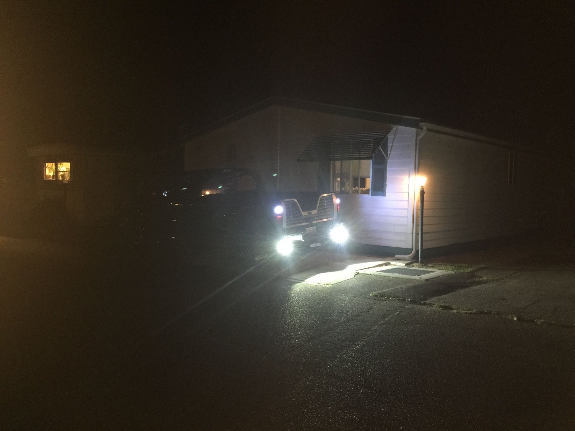

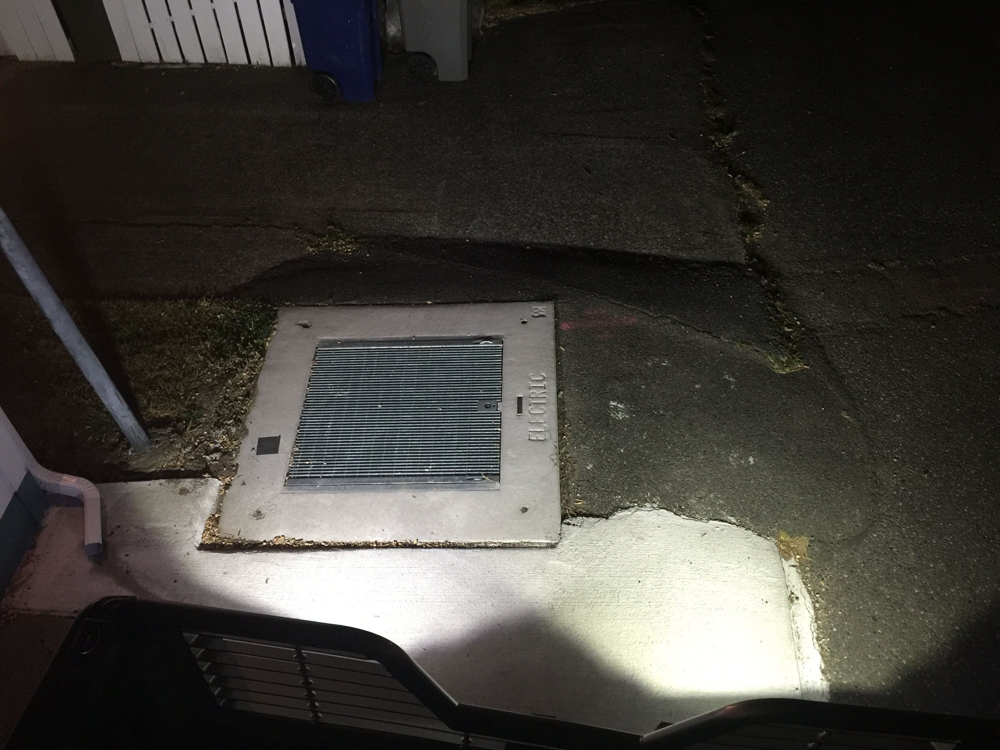

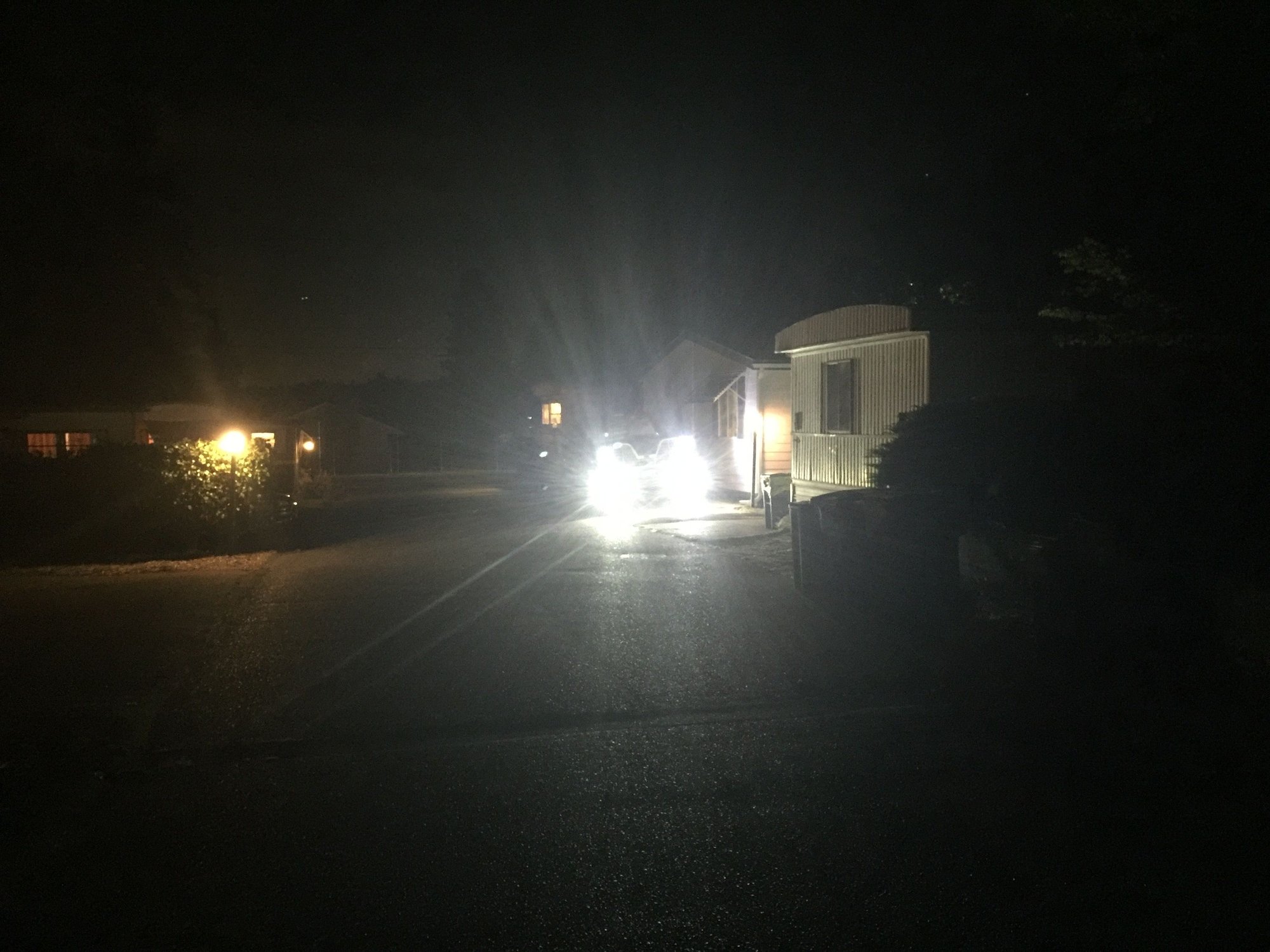

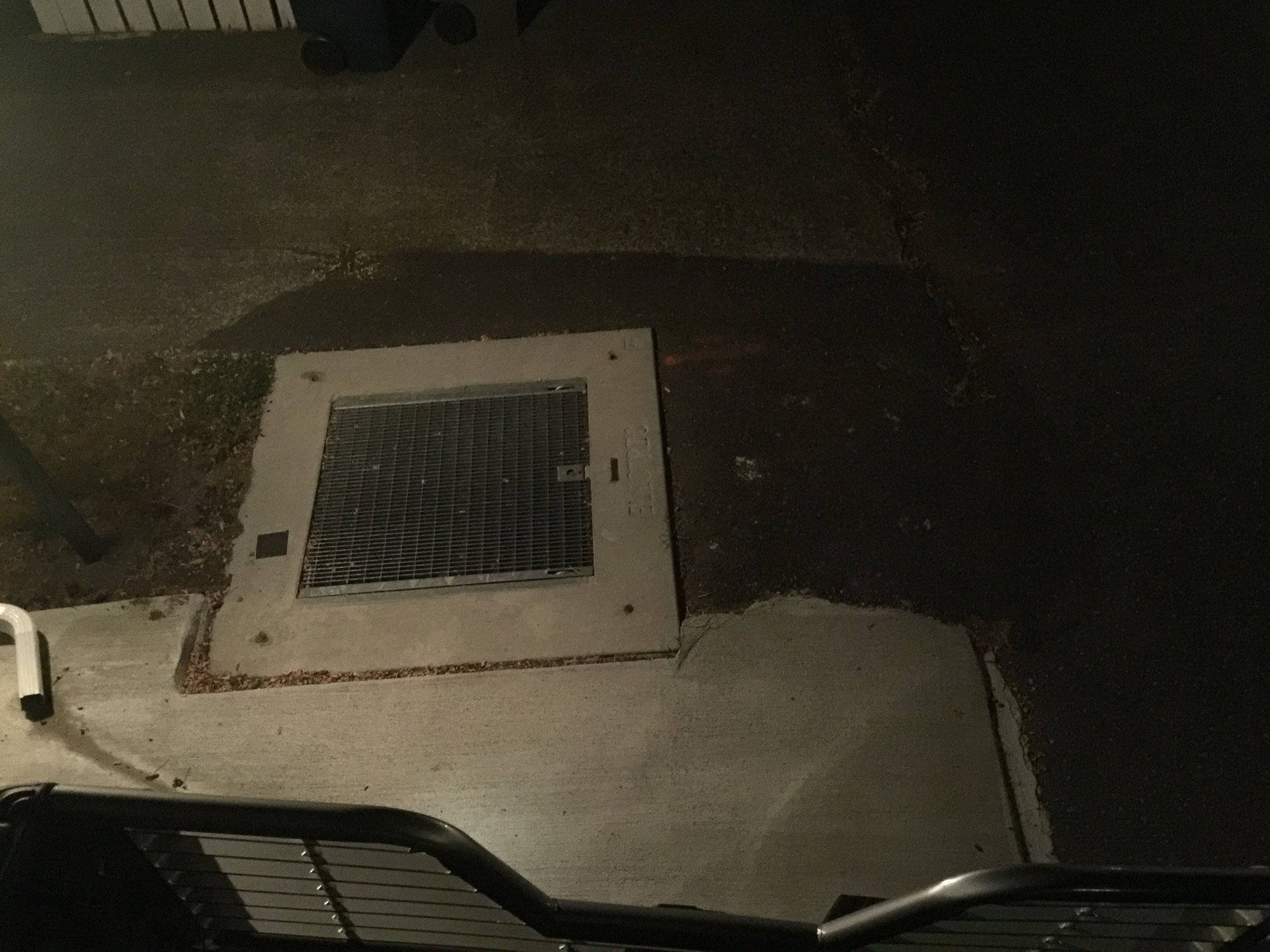

Old Aug 30, 2016 | 11:37 PM
14SD4Jeffro's Avatar
14SD4Jeffro
Joined: Jan 2015
Posts: 105
YMMV
on each side of the bumper, near the outter edges, but underneath, there are some fairly large torx screws:
for my led pods, I simply removed these screws, then run the bolt through the bracket for the led's, through the ring terminal for the light ground & back into the original location.
hot wire was spliced off my backup lights & you're done.
the next images are taken standing in the bed with backup lights off, with them on & then 2 taken from behind: first of these was about 1/4 block away & the final was diagonally from about 25 feet: sorry about the quality of the crappy cell pics, but didn't feel like lugging out my ginormous dslr
