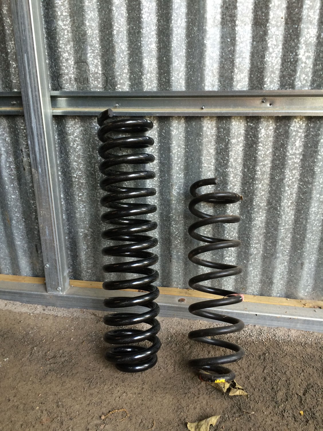

I went with Zone Offroad but I went 6" instead of 4" and glad I did. The quality seems fine and the ride is better than stock. A few pics to compare Zone vs stock
