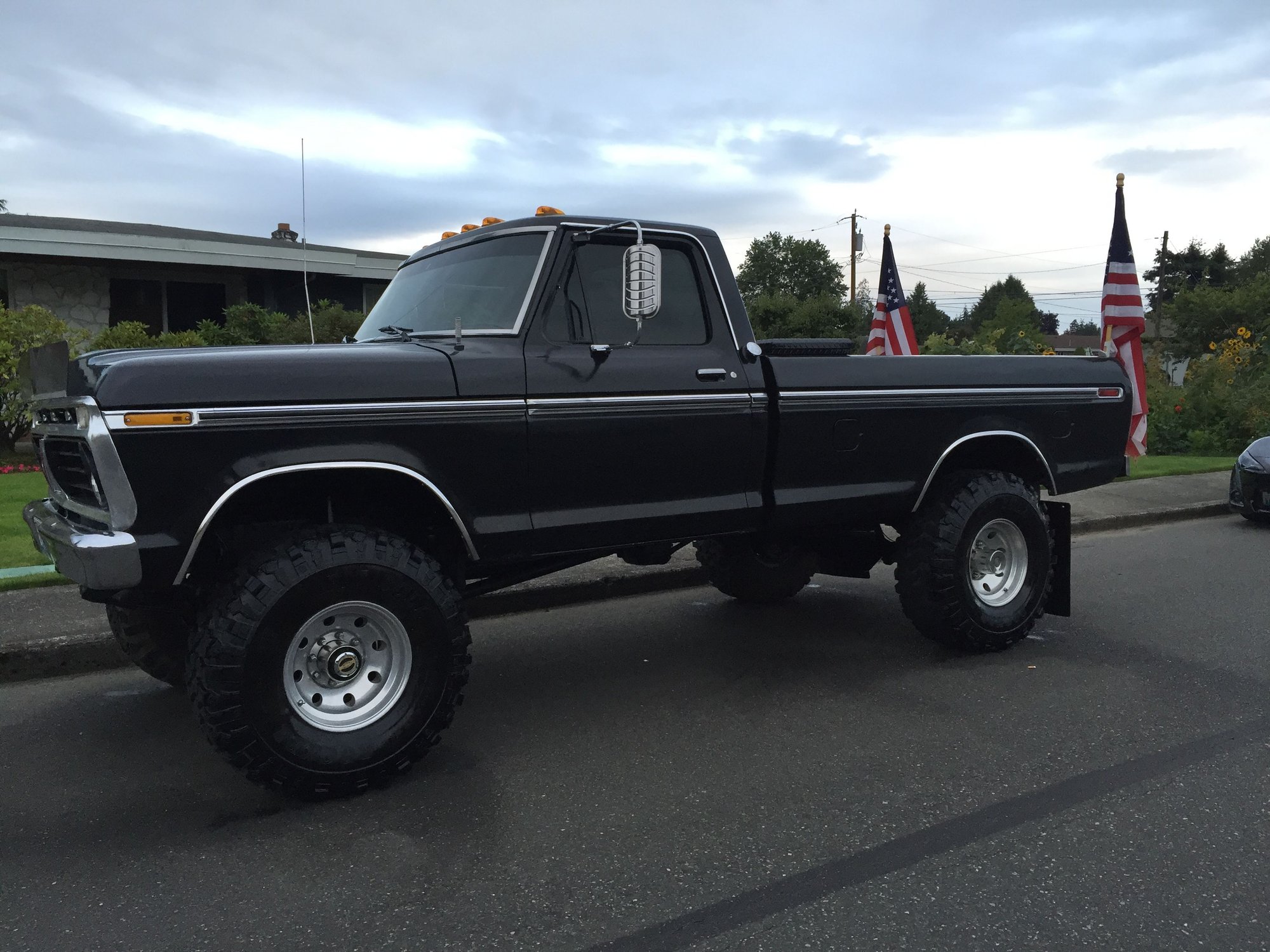

I did my highboy with rustoleum. Rolling it on with high density foam brushes. Turned out good for what I paid for it. For my crew cab project I'll be looking to an actual paint job. But the rustoleum route is a good route if you're on a budget and not looking to win first place at the car show, but will still turn heads on the street. People think my paint job cost 1000's haha.

Originally Posted by Coltin1992
Impressive
