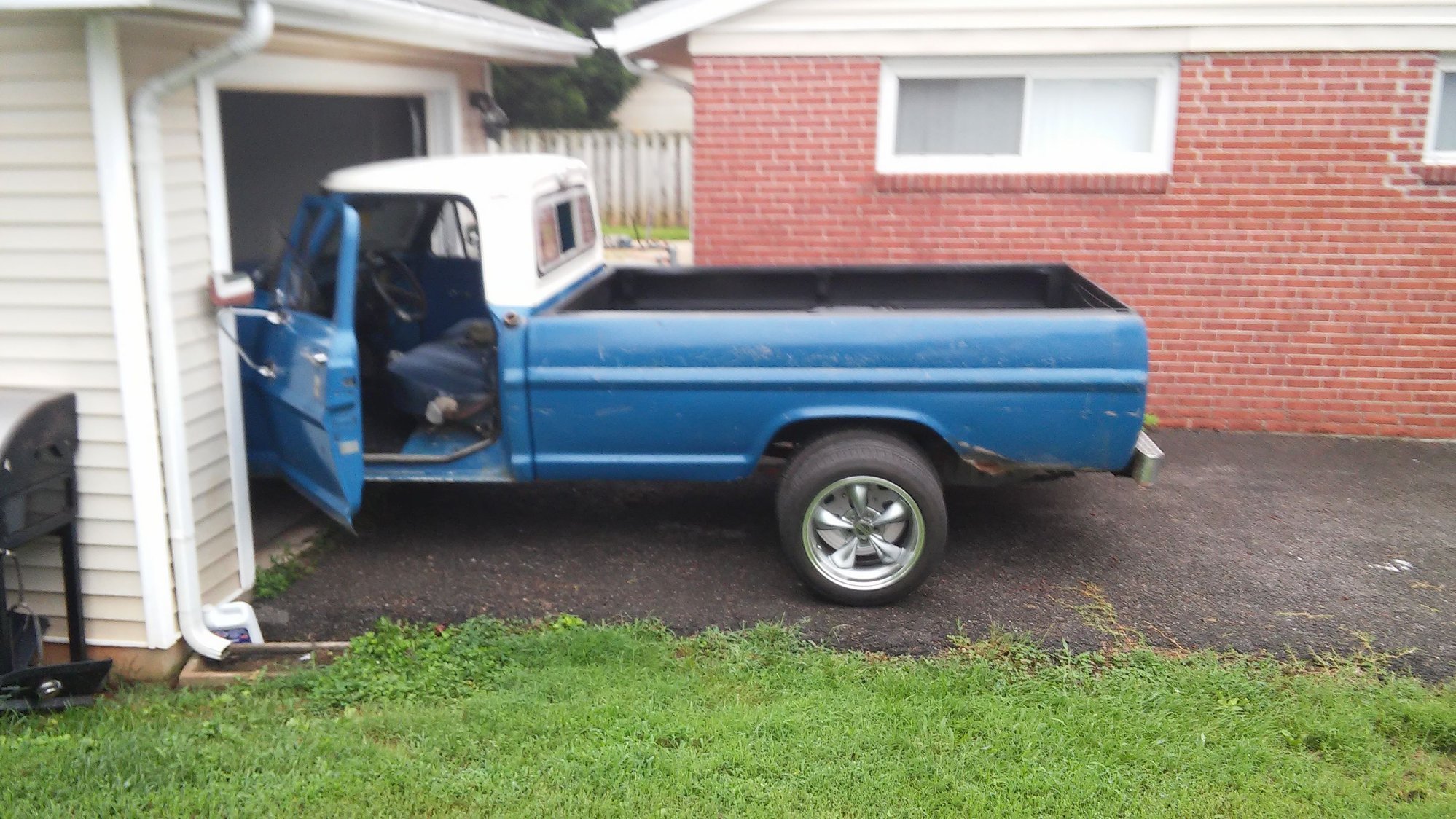

I picked up a set of wheels off a mustang for a very cheap price. They are 18x10 rear and 18x9 front with 6.5 backspacing. My 68 has a 79 disc brake conversion on the front and 79 rear end as well. I plan to order wheel adapters so the will fit the 5.5 lug pattern. Im wondering if I would have any clearance issues with these wheels. I will post a picture of the wheels shortly. Thank for any advise.

They actually work very well with 1.5 adapters.

I have the chrome 18" bullitts on my 64 which is on a 75 frame and I used adapters, it is tight but it fits. I did roll over my fender lip and I still have 3/4" room.
