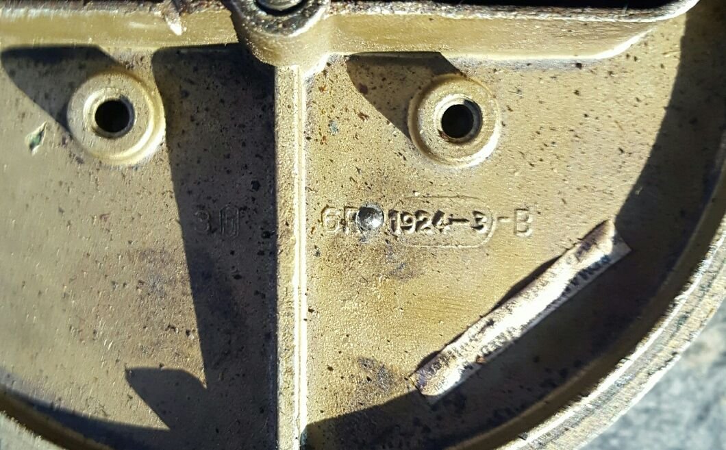

Mike's Carbs has never seen one of these so I thought I'd ask you guys if you have. It's a Holley 2300 that came off a 59 F100 in a junk yard. I plan to rebuild it for my 292. The engine it came from was a Y block, with crossover, that had Mercury valve covers. The numbers stamped on the air horn are B9AE9510ASX, LIST 2065-N and 6R 1924-3-B.
B9 is obviously the Ford number but they've never seen one that ended in ASX before. The LIST number is the Holley number but they've never seen a 2065 that ends in N before and 6R 1924 is also a Holley number but the only one they can find like it is 1924A. Any help would be appreciated!

Thank you NumberDummy. This is starting to make sense. Mike's Carb shop said
"B9AE-AS is a good carburetor number but it isn't in our manufacturers catalog for kits, sorry."
So, ASX might not actually be the part number but an indication that I have an AS carb that's been factory rebuilt and restamped?
I see the AS # listed there but it has a different parts listing # than all the rest. Is there any way to know what's different? Odds are pretty good that I wouldn't want whatever was different about it, so, my next question is, do you think a kit for a 9510A model work just as well?
