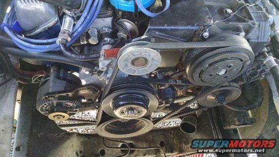

It helps to know what engine you have. My 460 only uses the crank pulley to run the alternator. My power steering and air conditioner run the water pump.
In my case it only goes around the crank but you must first remove the other belts.
If the belt is supposed to go around the water pump you can run the belt over and in between the fan blades on eor two blades at a time to get it where it needs to go.

The belt pattern on my 400 with A/C looks just like this as well. As Orangeford said, you have to have the outer belts off before you can get the alt. belt on.

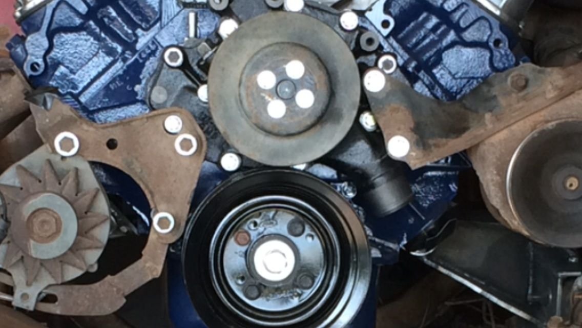

Like orangeford pic shows, my alt belt only goes around the crank. I always have to remove the water pump pulley to replace the alternator belt.
