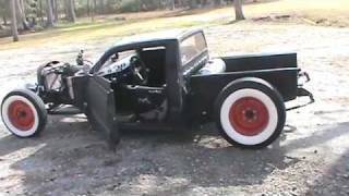

i plan on making my own frame and by using a 9" or my 60.2 (was in my 66 f-100 camper special 5x5.5 pattern) so the width isn't an issue.... on the exhaust i plan to get a make your own style set and go out over the frame and finish as a set of side pipes (referred to as lakers in my area)

these are the ideas i am working with so far... i like the design of the bed on the top but i despise chopped roofs and besides my donor ranger is a 96 so im looking at a little different body outline... but i also plan on it being open motor like the bottom picture but i know i would no be able to get any traction whether i go 460 or 390/445 so thats why i was curious about the d44 and d21 tcase but from talking to my mudracing buddies i think im going to give up this idea due to all the breakage that is obviously going to happen... i will be starting this thread sometime soon in the ranger section

Proper rear suspension with no wheel hop, 90/10 front shocks for weight transfer, your gasser stance, and the right tires ought to hook you up once you figure out the right gear for your combo.
