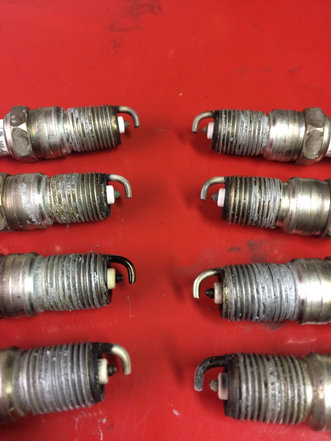

So tonight as I was warming up on my way home, I noticed a wet spot under the exhaust, took a whiff of the pipe and it seems I'm running pretty damn rich.
Got home, removed the plugs as you see below. Now I don't have the experience that a lot of you do, but something doesn't look right. #2 is a lot darker than the rest, and I thought I saw some fuel along the base. #6 is bar far the cleanest with almost no sign of anything dark or gray. Also #2 had a crack in the ceramic, so I'll replace it tomorrow.
I removed the 6" tube I had in front of the MAF think it could be an issue: no change. I tried to jump the two wires on the self test connectors to do a KOER to no avail.
Thursday I'll check continuity to all the injectors, and hopefully pick up a stethoscope to try and hear what they're doing.
I'm about ready to hand it over to a mechanic...I'm almost all out of ideas
#2 is blacker on both sides, does that mean its rich? Stuck injector? Notice the crack in the ceramic, its getting replaced.
#6 has almost no color at all, not sure what to make of it?

Are those platinum tip plugs? I ran some in my truck for less than 2000 miles they caused pinging. Went back to copper core Autolite and no pinging for 60,000 miles. They platinum plugs self clean by the tip staying hotter and burning off deposits. Hot spots = detonation/ pinging

Back to the plugs...I'll switch over to copper core but do they look OK otherwise?

I switched to cooler plugs from Autolite; I think it helped somewhat, still pings at low RPM under load, though less often and "softer".
