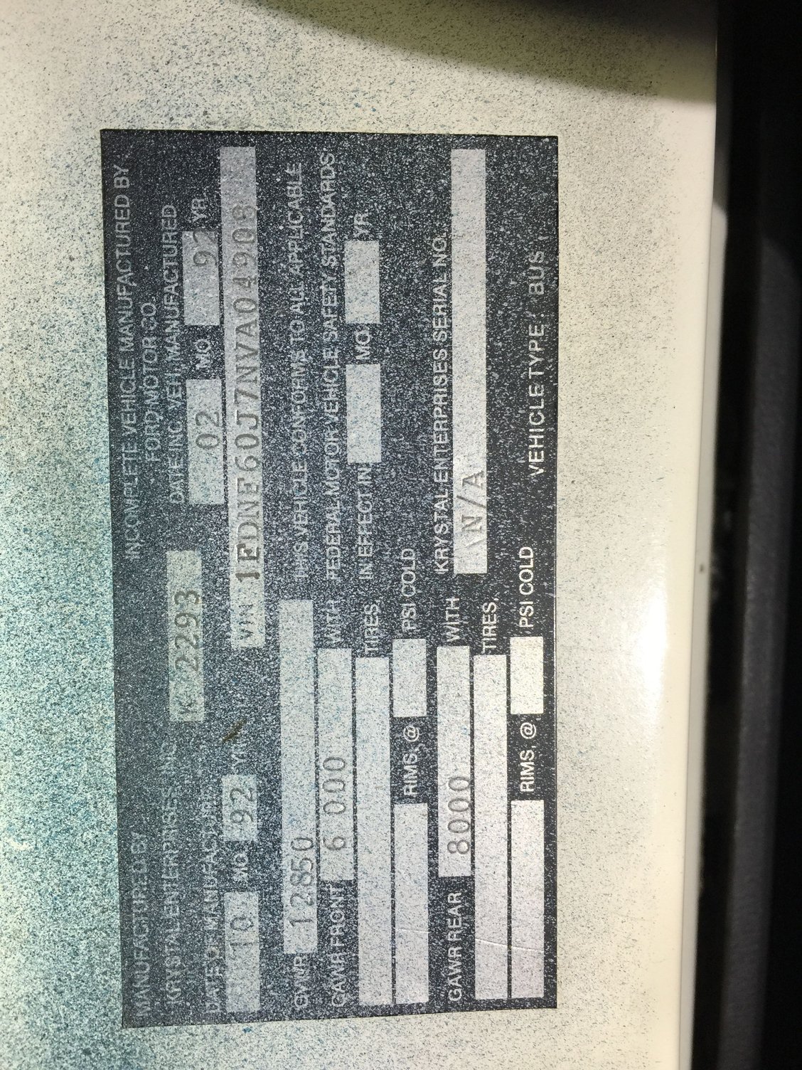

TRANS & AXLE codes printed on the Certification Label, glued to the left door face below the latch.
Post a pic of it.

It's a Frankenstein truck. This is the only sticker on the door.

12,850 GVWR with an 8000 GAWR for the rear axle is very low for an F600. That's more F350 territory.

That's my Frankenstein reference. A VIN search tells me it's an F600G 7.0L straight truck with a standard cab. If that's the case, this truck is made of at least 3 different trucks. With the existing powertrain and chassis I guarantee it's much more than F350 GVRW. I haven't weighed it yet, but it must be at least 10K by it's self. I'll keep digging, looking for more numbers.
I thought you said the chassis came from a bread truck or some other delivery van and the pickup body was installed on it? You need to find a VIN on the frame in order to identify at least what the year model of the original truck was in order to narrow down the possibilities for transmission and rear axle choices. The VIN on the cab is meaningless if this is a re-body.
