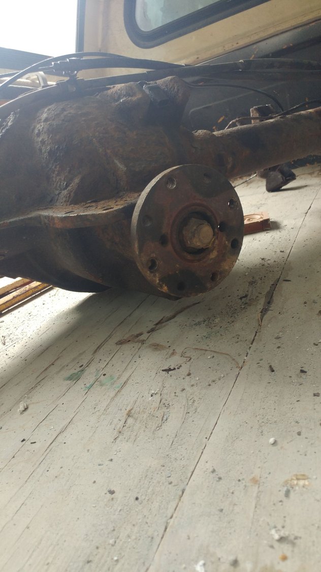

My prop valve came today, I didn't install it yet though. Also, do you think it's worth while buying this kit?

I put the proportioning valve in, now my front left brakes are staying on any ideas?

Also the brake pedal isn't returning all the way up so the brake lights stay on

I changed the caliper and I think its fixed, its kind of strange though, that the caliper got frozen on after installing the prop valve. I drove it for weeks before hand and the caliper was fine..

looks good, so are you happy with the braking and does 4 wheel disc seem more firm than stock?

Sorry for the confusion, but I didn't swap the rear yet, I just started by installing the adjustable proportioning valve

remember, caliper brakes uses more pressure to create stopping force. if your prop. valve is adjusted to be used with w/calipers there may be too much pressure delivered to the drum brakes causing them to lock up. be cautious with these modifications.
