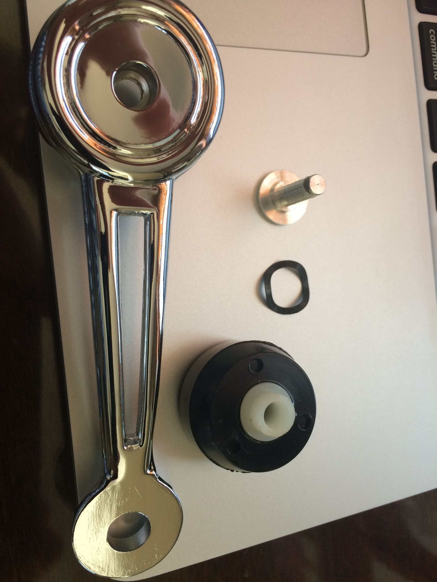

I purchased new window handles and ***** from LMC. Where does the "wavy" washer go? Between the **** and the handle or between the screw (that holds the **** on) and the handle?

I looked it up in the parts catalog and the wave washer isn't a part of the oem set-up, I don't see it in the illustration and can't find a part number. From the looks of it though, I would say it goes between the **** and the handle.

All the replacement ***** came with the washer. And...to install the **** on the handle, it must be pressed on...using a vise or press.
We told people that at the parts counter, but some came back the next day to buy a new ****.
They tried hitting the pin that fits into the **** with a hammer to install it...which shattered the plastic.

So it goes between the **** and the handle? Would a C-clamp press it on?

If the person that purchased a **** brought the handle, we would press both together...slowly...with a vise. No charge, of course.
I don't know if a C-clamp will work, as it takes a lot of force to press the **** on.

If that washer fits in the handle, that is where it goes. If not, must go on the back side over the press in pin.
