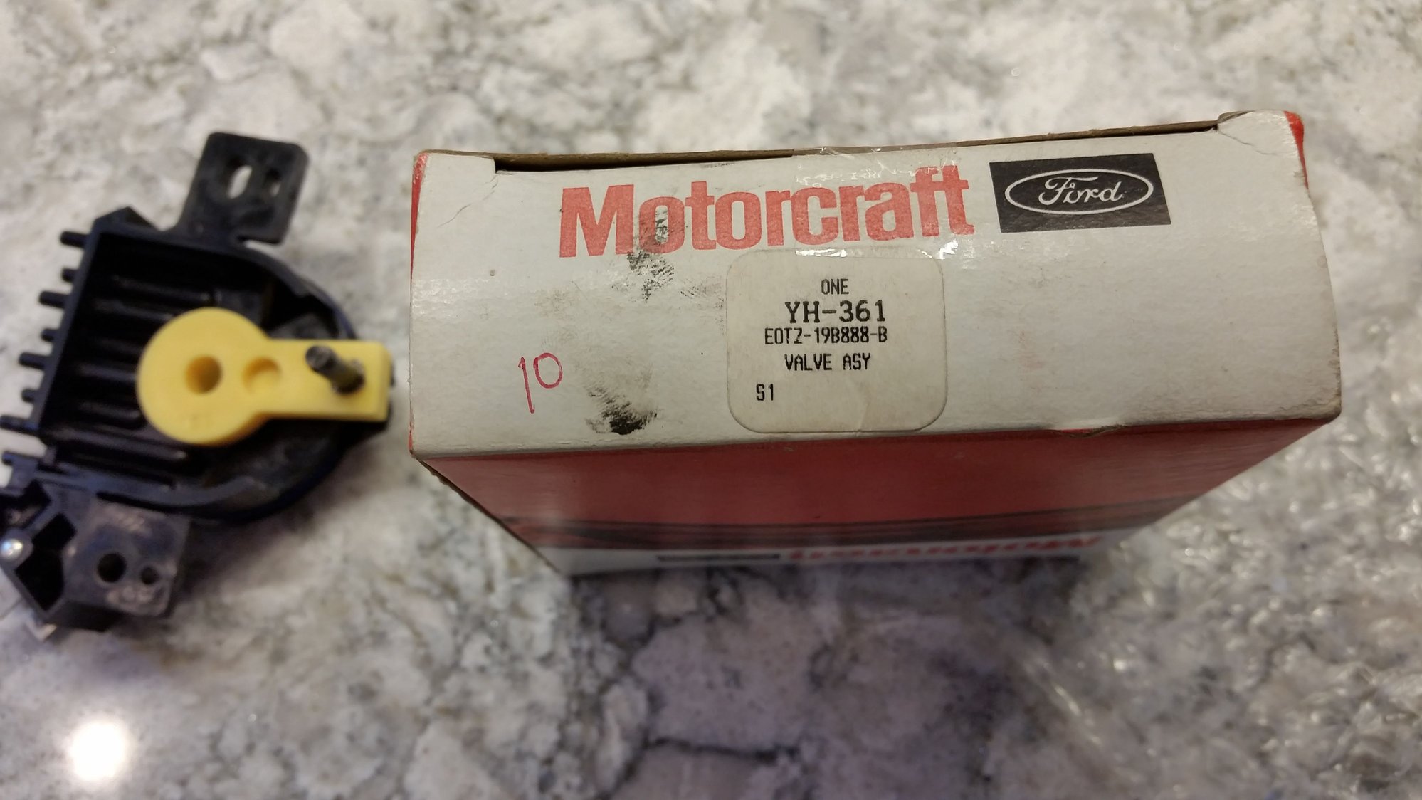

Well, it showed up today, and I got ready to install it, and it is different. Maybe still works, but not a direct fit. It has 3 terminals instead of 4 as the original did. That said, on the original, there were two brown/white which were both +12V, and the orange/brown to blower and I can't remember other color. So maybe it works just sending both brown/white to one terminal. I will use ohmeter to figure out switch so see if that would work.
Some pics:
the box:
The old switch terminals:
New switch terminals:
Numbers I could find on new switch:
D5TA19B919AA

If they misrepresented the item you should demand the charges are reversed.
Gary's piece clearly shows the correct ID number, and the page shows the Motorcraft cross.
The box shows the correct part number.
I can only think that somewhere over the years the wrong part got slipped into that box.

I agree with Jim - right box but wrong part. And, that's becoming the case more often as we get to the bottom of the bin on parts. Someone probably pulled that part and started to install it, only to find it didn't fit. So, back on the shelf it went. And again, and again. Always the bridesmaid and never the bride.
