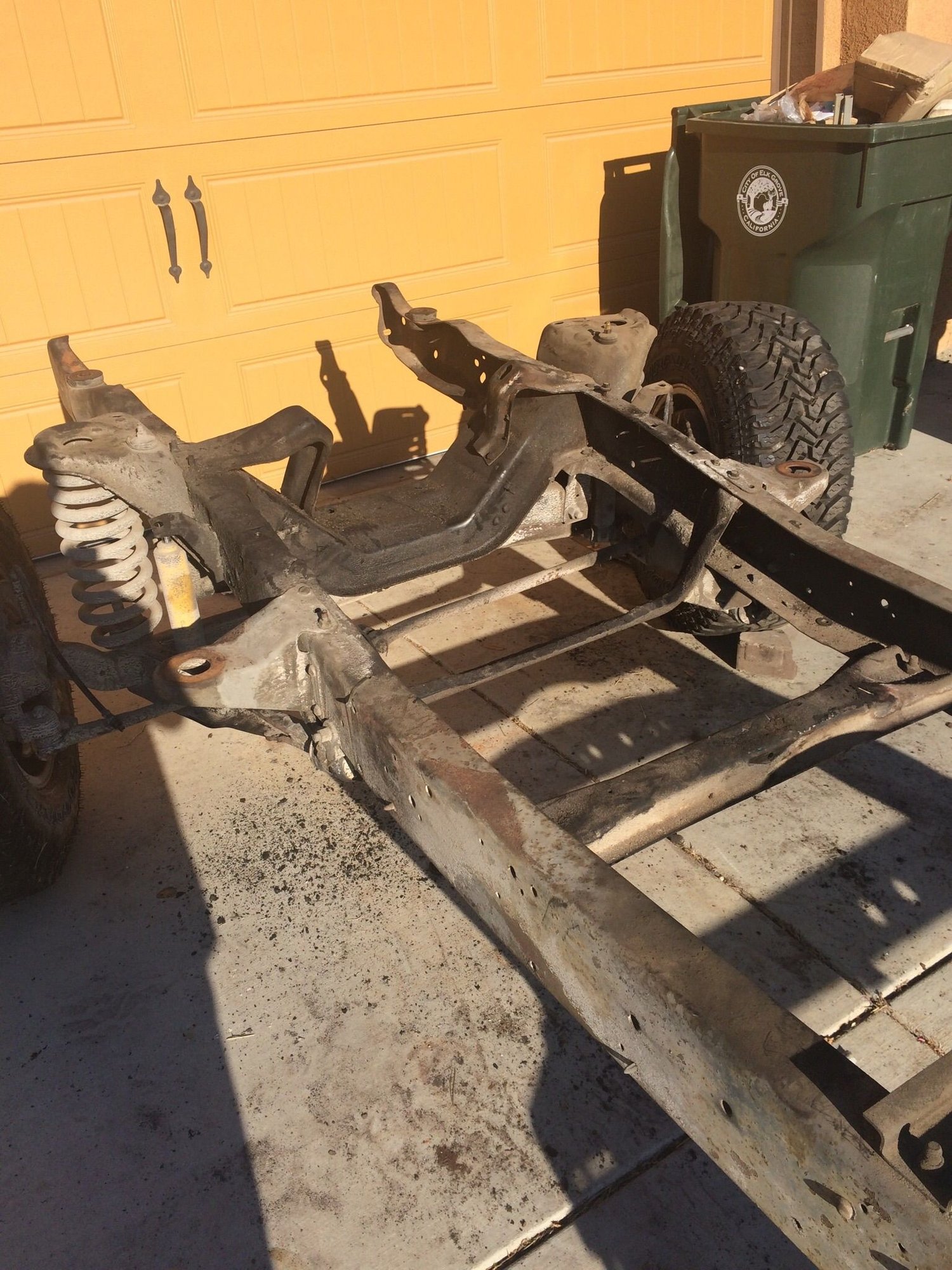

Brake advice
Pre blasted
Post blasted first coat of rust bullet<br/>
