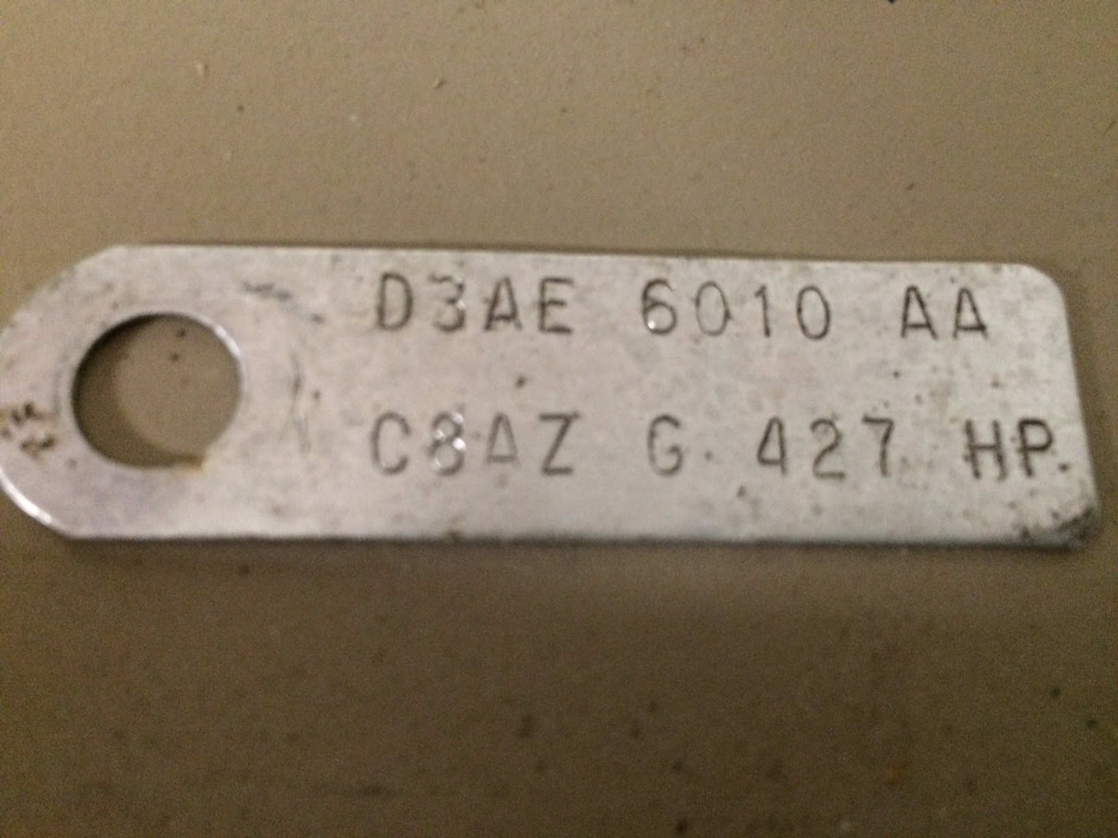

And here's a slightly later tag showing how they removed the FoMoCo in the upper right corner and changed the layout some. Can you tell what engine this is?
Attachment 152519
It's a morphodite. It's not an FE engine with that D3AZ (1973) block casting number. But, C8AZ-G could be a 360/390 bare block.

It's not an FE engine.
Technically, no. It's from the block of an NOS 427 side-oiler that I've had sitting here for years. So not a complete engine.
I'm sure the tag on an actual 1973 truck is different than the tag I show. I have the MPC so I'll take a look. Just having some Friday afternoon fun....
D3AE block casting number: It might be a marine engine, or a service part, since the last year the 427 was factory installed was 1968.
Yes, it is one of the NOS service replacement blocks that is drilled for hydraulic lifters so you can run them or - with a little rework - run the solid lifters.
The marine blocks had the large round brass knockout plugs on the sides of the engine for the water jackets, but not the brass threaded plugs with the large allen heads like this. The block is a work of art. A bit of cosmoline still left on it. Not sure why my pic is upside down, but there it is. The bores all measure 4.2250 give or take.
