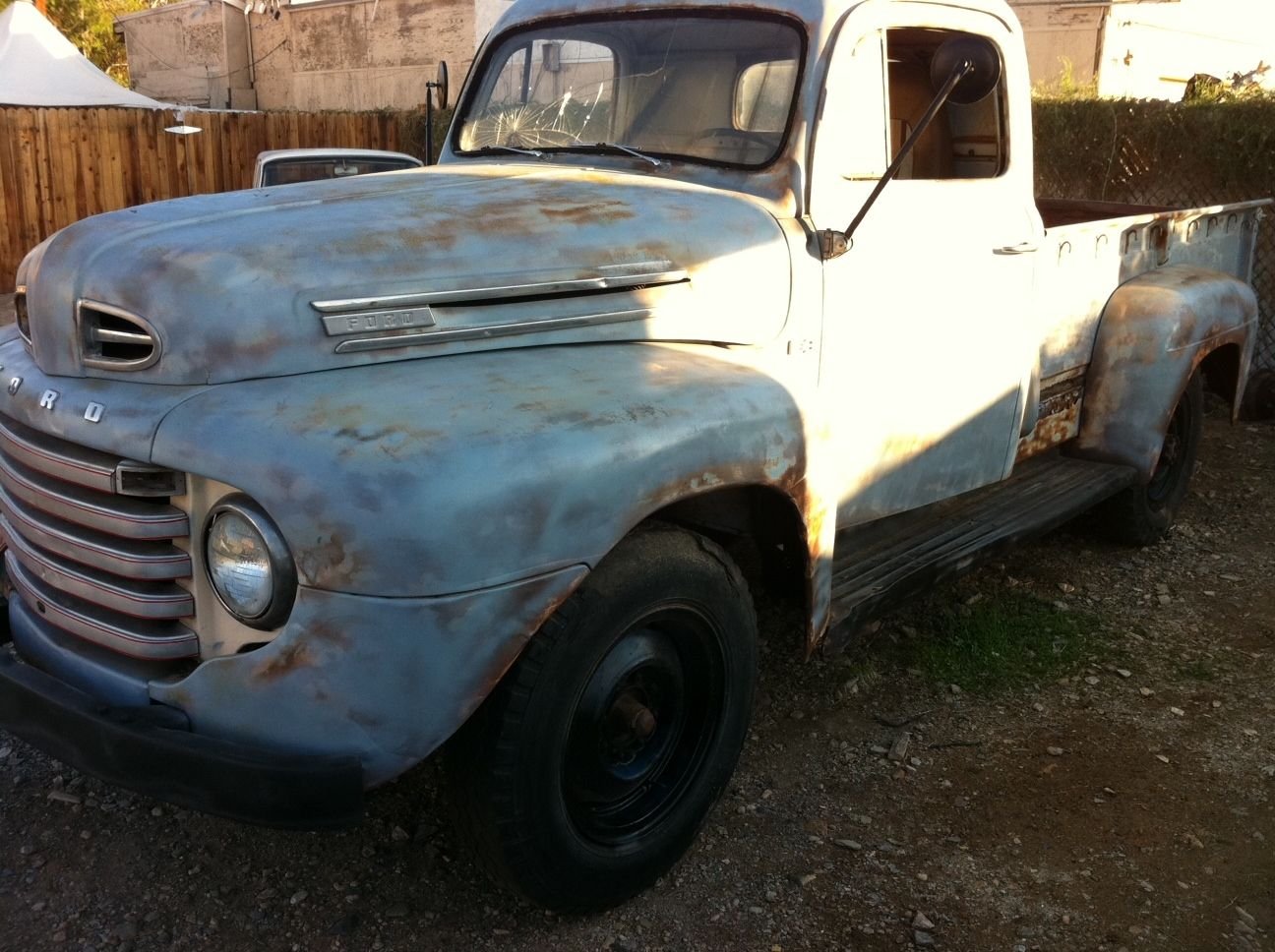

I've read on this board and other publications that the '48 Ford F series grilles had a red pinstripe. Does anyone have a picture of this? I'm nearing (hopefully) the end of a restoration on a '48 F4 and I'd love to put this pin stripe on.

I have a couple of photographs (not mine) of pin striped grills. I do not have the ability to post them though. If you message me, we might be able to work it out so that I can send them to you. regards, Rustybits

I believe someone put a 48 grill on my 49 F3 (I am starting to see signs of a small accident and panels could have been replaced) and the striping is on the top and bottom of every grill slat.... hope it helps.

here are the pics from rustybits.

Mine looked more like the bottom photo than the top....

Here's the story on pinstripes: https://www.ford-trucks.com/forums/1...ml#post1234340
The ones I've seen, the red stripes were on the recessed part of each bar. The first picture above looks wrong, the second looks closer but still on the faces of the bars.

As others have mentioned, the 48 grilles were painted tan (all references I've seen are Tucson Tan) with the red stripes similar to the 2nd pic from rustybits. Ross is correct regarding the placement, to my experience.

wow, so now I'm really confused on the grille. I've seen pictures of these trucks with the tan grille but most I've seen had silver grilles. Here are a couple of pictures of the F4 I've been working on in "as found" condition. The picture quality is bad but it appears to have a silver grille; of course I can't make out any stripes. Three other people 'worked' on this truck before I started so I'm not really sure what it's original condition was. The grille had already been sanded and shot with yellow sealer when I got it.
So what would you guys do? Should I leave the grille as it is now, or should I put the red pin stripe?
