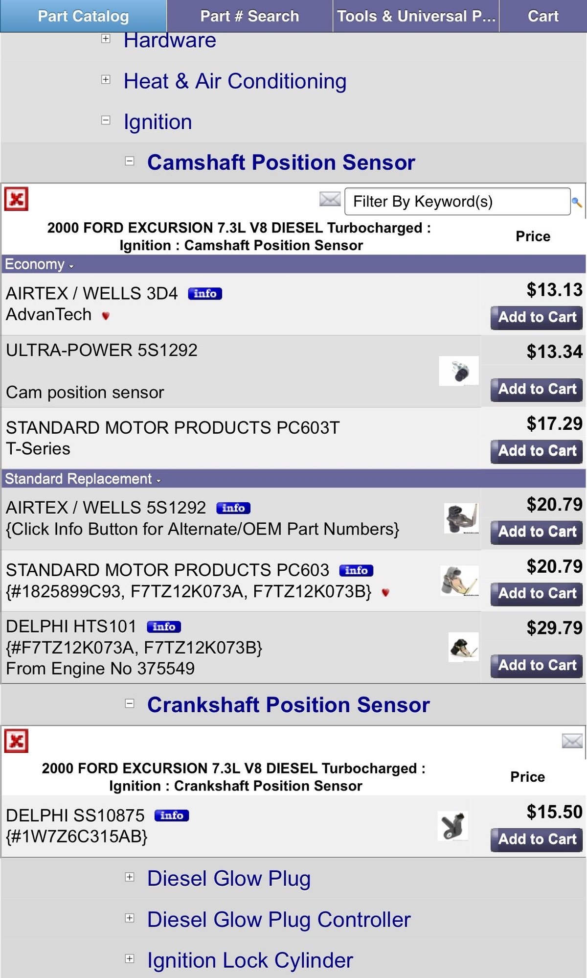

Rock auto has the OEM Motorcraft for $19.95........

Couldn't find it when I checked right quick before I posted, might've glossed over it.... Been all over the place today moving houses.
Unless we're getting different search results for the same vehicle, all I see are the Delphi, Ultra, Airtex, and Standard Motor Product... None of which is the Motorcraft variant.

Yeah.....It's there if you do a parts number search for F4TZ12K073C......It is out of stock now......Probably why it did not come up in the general search.

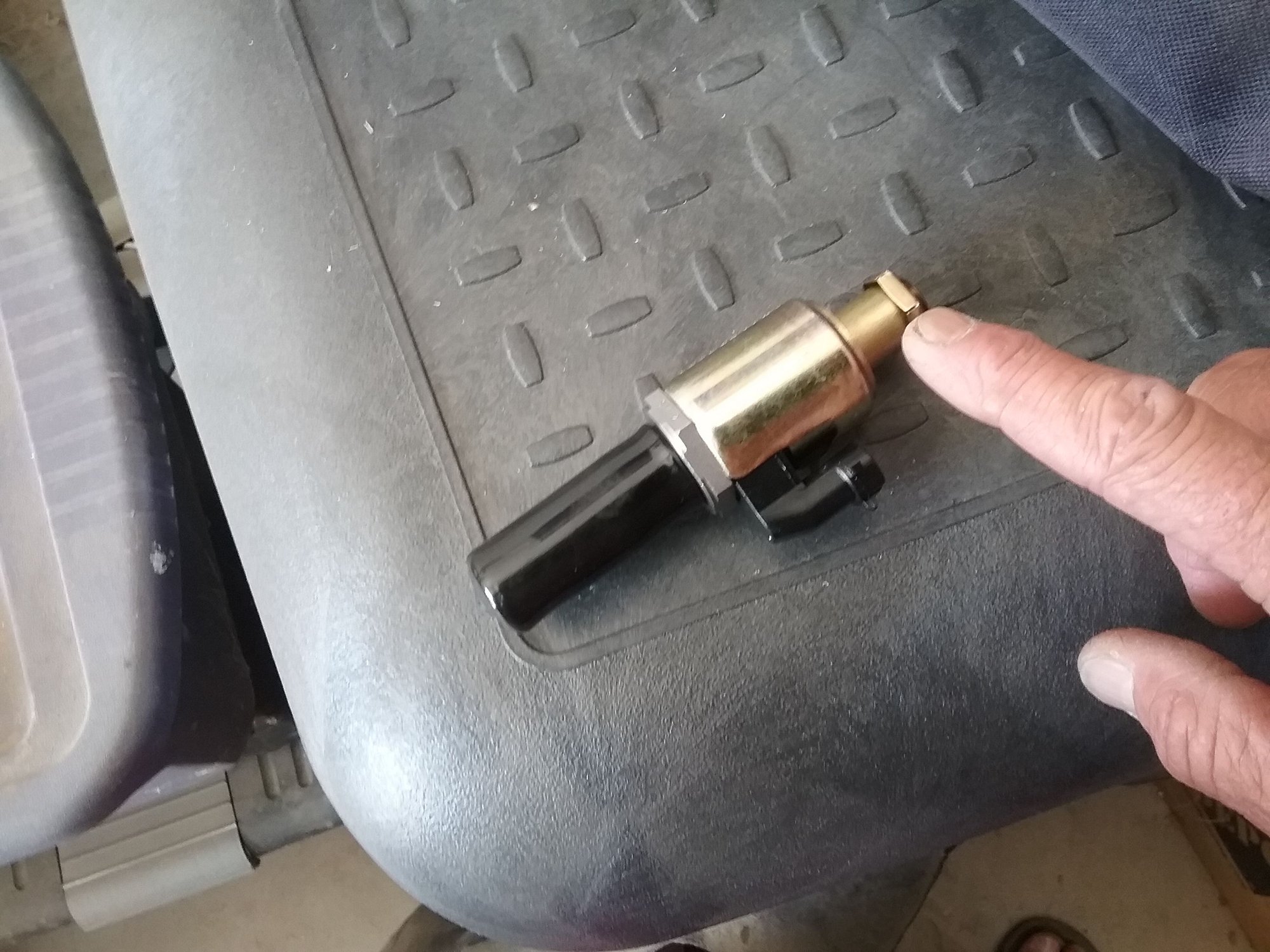

Check the nut on the ipr if is still on. Will cause a a stall.
( chances are the nut is still in the engine valley if that is your issue)

Ruffneck30:
Could you please elaborate on this?? What is the IPR? Where is it located? Is the nut supposed to be on or off??

Originally Posted by swmpbgy1
Ruffneck30:
Swmpbgy1
I'll jump in on this one . under the fuel bowl is the hpop you will see the ipr (see photo )the nut is what my finger is pointing at
