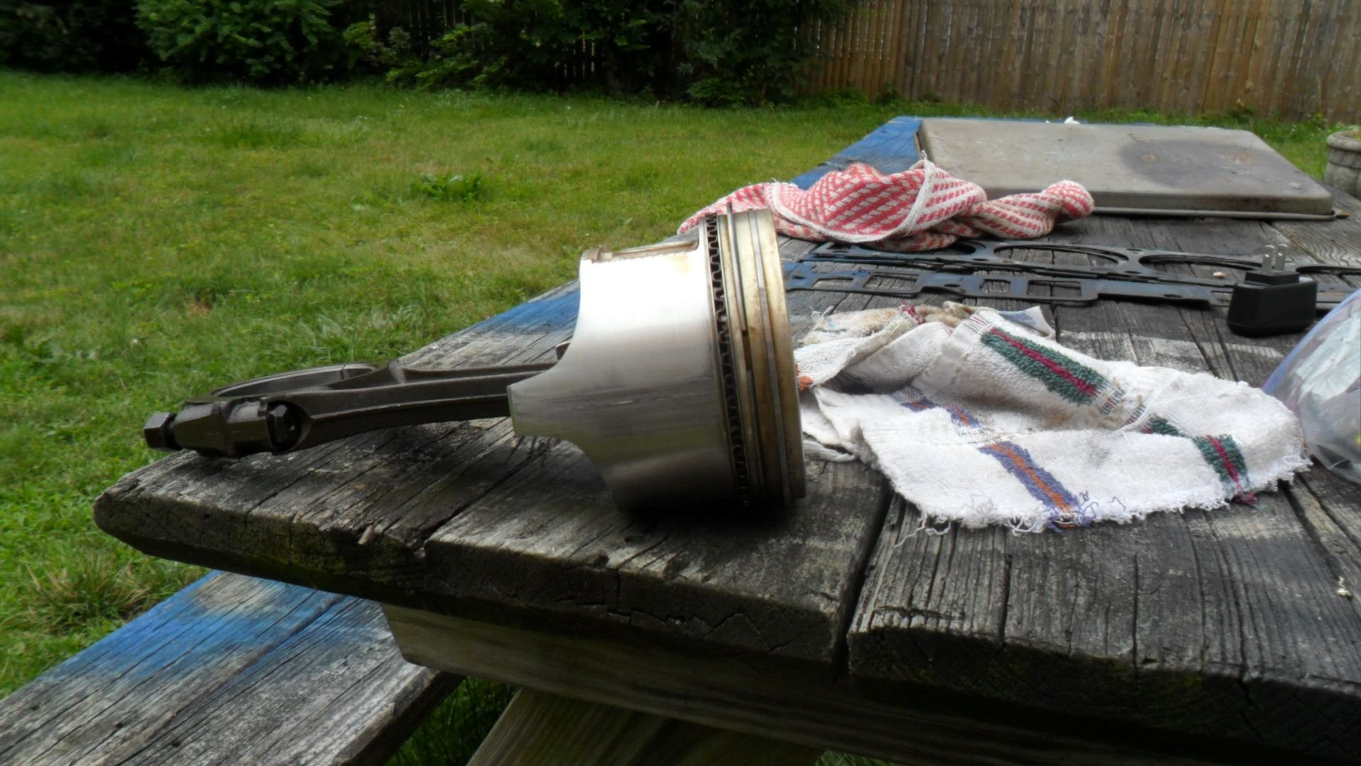

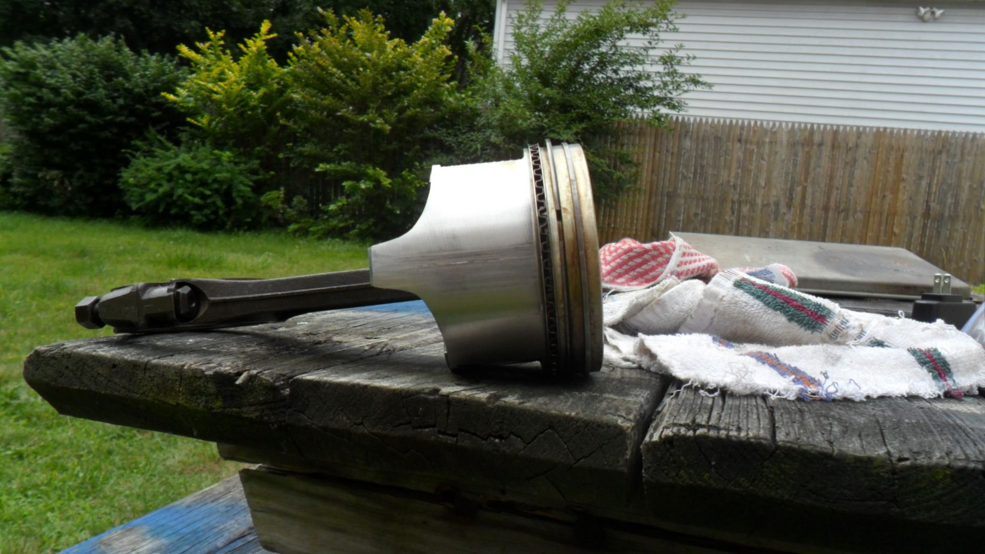

Here's piston # 1. The marring I was seeing on all the cylinders is from piston slap. It's uniform across all cylinders from what I can see. A quick wire wheeling gets rid of it.
The rings look good on this one but I know it isn't easy to tell just by looking.
So, my first thought on the cause is timing? What do you guys think?
