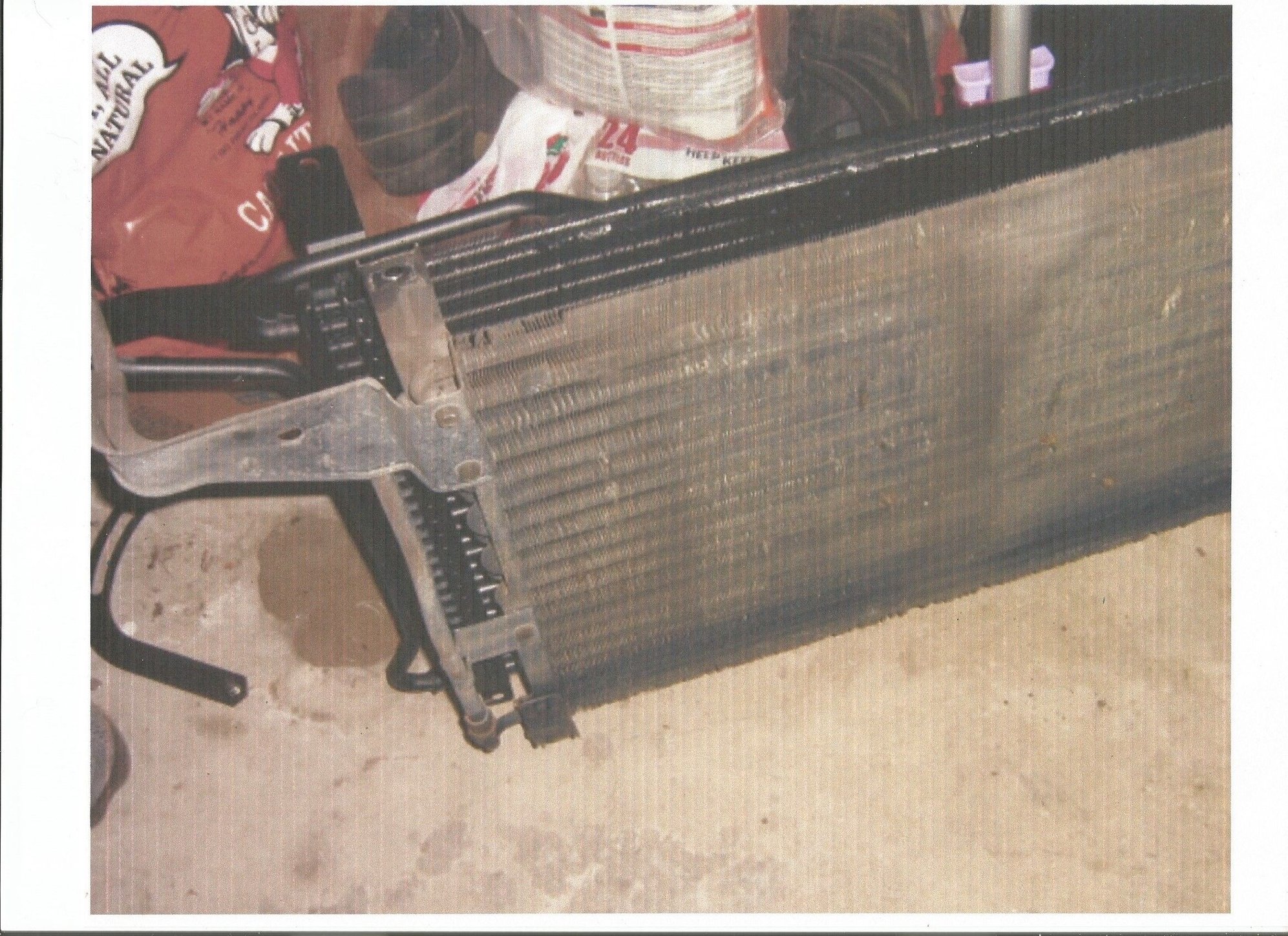

Ah Ha! This the only pic I found. Hope it helps.
Tubing is very different too. Many more smaller size tubes than OE. Maybe you can see that with this pic.
Dave

Thanks for posting the picture.
I hear if using R134 you want to run a larger condenser but if the tubs are in different locations that could be a deal breaker.

Well my Ford parts researcher found what happened years back. spectra used those numbers too. My photo is true. I've been dealing with this for a few weeks now and the info I gave is correct. Just trying to save you the grief I've had. I wouldn't post anything about the problem if I didn't already have hands-on experience with it.
