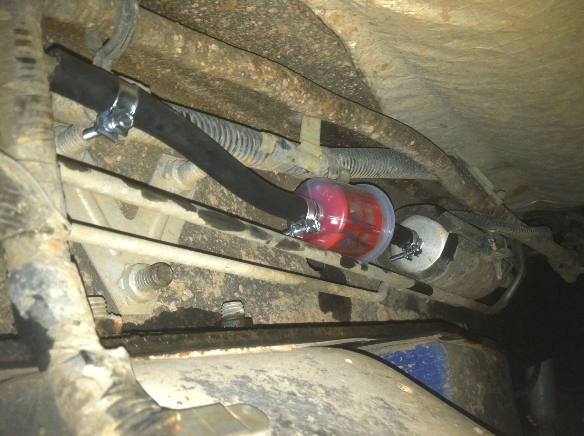

Might as we'll add pics...
WIX 33972
This is how I do the pick-up mod. The return hose is cut in the bend so it can be pointed 180* away from pick-up.
