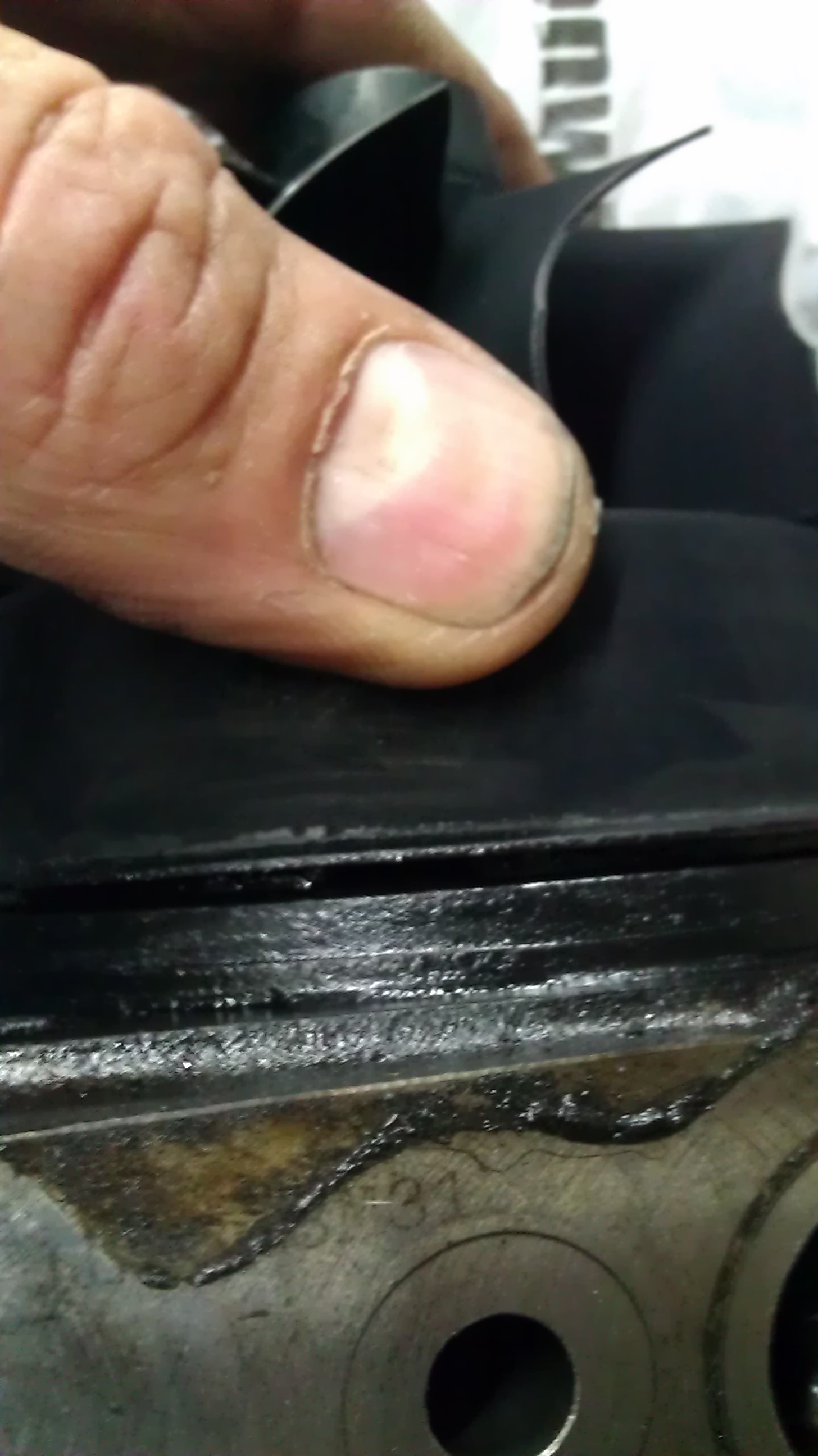

I vote that it's not your valve seals. I had a similar problem with my truck a few years back. Oil consumption was not excessive (1 to 1-1/2 qts per 5k miles), but had smoke haze when cold until it warmed up. I replaced the valve seals when I upgraded to the Comp Cams 910 valve springs. The seals did nothing for the oil haze. I finally changed out my "non rebuildable" 38R turbo and the problem ceased. I came to the conclusion that the seals in the turbo were allowing some oil to pass until they heated up. You can see the oil behind the heat shield on the turbine side of the center cartridge in this picture.
BTW, I have a tool that I fabricated to R&R valve springs that mimics the Ford Rotunda/OTC version. The injectors do not have to be removed. Each cylinder is brought up to TDC and the valves rest on the piston while the valve springs are removed. Here is my write up with pictures. https://1drv.ms/w/s!FoWd-ifCIbJFgRxmIXk5enZvUThacyQM
Attachment 151151
Thanks gain for the write up! While I am replacing the valve stem seals I was going to go ahead and replace my lower plenum boots that I ordered from riff raff. Should I look at anything on the turbo other the exhaust pipe when I have the plenum removed to check for leaks??
