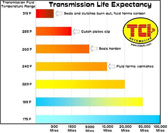

I have used this as a guideline. Below 220 deg F is no worries. 230 deg F is the upper limit I ever want to see and for not too long. Above 240 deg F is when internals and fluids start to break down. It is always a temperature over time formula.
Transmission Life Expectancy - TCI® Auto
No worries?! That chart says my transmission would only last 20,000 miles at 220! That would worry me, especially considering how my transmission has a thermostat that regulates it to 200 degrees nearly all the time. Does that mean it's only going to last 50,000 miles?
I've seen that chart before, and I don't think it has anything to do with reality.
I tend to ignore the horizontal axis numbers. I look at what happens on the vertical axis with temperature.
That chart is nothing but lies. Everything I have quoted, above, is lies. Internals and fluids DO NOT start to break down at 240F. Maybe they did 50 years ago, but the modern fluids and materials that are in current transmissions DO NOT have this problem. You're just spreading misinformation.
