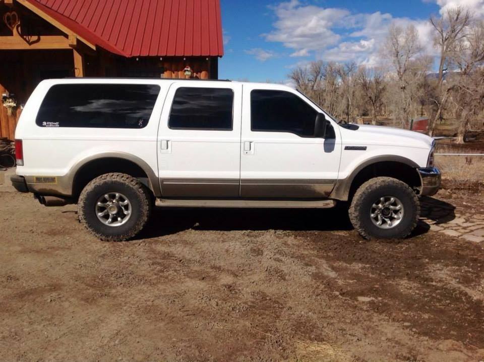

On my old 16's I ran the same size, 315/75's, and I have a 4" lift. Here's a pic of my old setup
At full lock, it would rub the rears of the front springs and the tires were uncomfortably close to the wheel well liners and bumper. You can pull the liners back a good 1.5" or so if needed. Based off this picture, if the suspension was 4" lower (i.e., stock), the rear of the front fender would be IN the tread on anything other than flat and level ground IMO.
