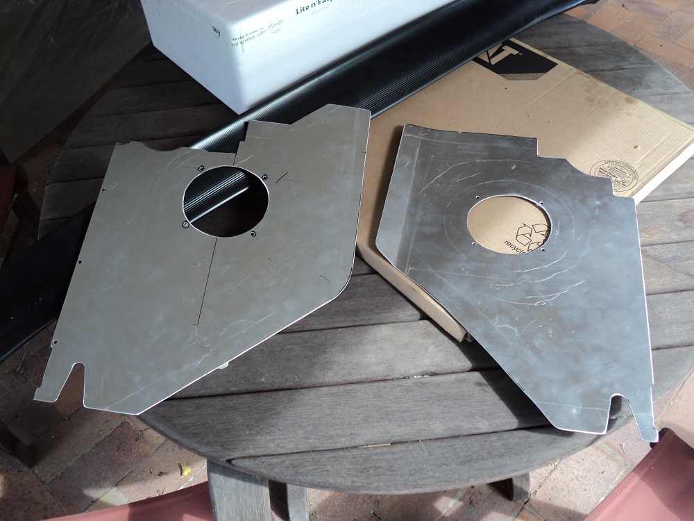

G'day guys, haven't started the engine yet, I'll paint the dump body first, but so far all the electrics work. I used a micro switch ( similar to a Jake Brake one) for a stop light switch, it's rated at 15 amps..... more than enough. The kick panels are 1.6mm aluminum with rubber glued on.
Getting some windshields cut, and hopefully fitted on Friday after work.
Here's a few pics, Cheers, Steve.

Hi everyone, the turn signal assembly was purchased from C&G Early Ford
Ford - Parking Light Assemblies
the turn signal switch on the column is Mack CH... the clearance light flash
button on the end of the lever is now horn.
