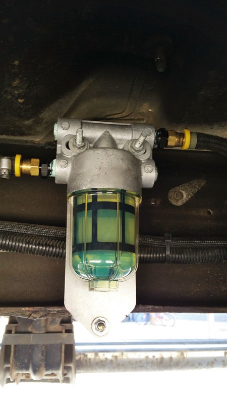

Many of us use the PS120. It has a clear plastic housing around the filter which is goof for quick visual inspections. It uses the 3/8 NPT fitting size.
Racor PS120-02 - PS120 Series Strainer/Prefilters - Mobile Fuel Filtration
