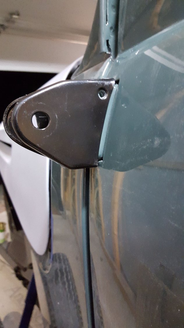

I've been trying to find a replacement for the set screw that secures the base of the door mirror to the top door hinge. Based on the tap that seems to fit the opening it appears to be a 12-24 bolt although none of the hardware stores in town carry that size. Can anyone confirm that I'm am I looking for the correct size? If so, any ideas where to find one?

The parts manual calls for part #*39051-s2 1/4 - 28 x 1/2 and lock washer.

12-24 and 1/4-28 are so close I'd just drill and re-tap 1/4-28.

Originally Posted by D Sokol
The parts manual calls for part # 39051-S2 1/4 - 28 x 1/2 and lock washer.
Obsolete - No Ford dealer or obsolete parts vendor has any.
Shown as 39051-S in upper pic.
Parts catalog pics of "standard" parts may not show the complete suffix, so one has to look in the text section to verify the part number.

Thanks for the info. I'll try to find a 1/4 - 28 and see if that works.

It was tough to get a 1/4-28 tap started in the hole but once I did it cleaned out a lot of primer and paint that was plugging it up. That seems to be why I originally thought it was 12-24. Found a 1/4-28 x 1/2 cap screw at Ace Hardware that works fairly well. not original but I think it looks OK. Thanks for all the suggestions.
