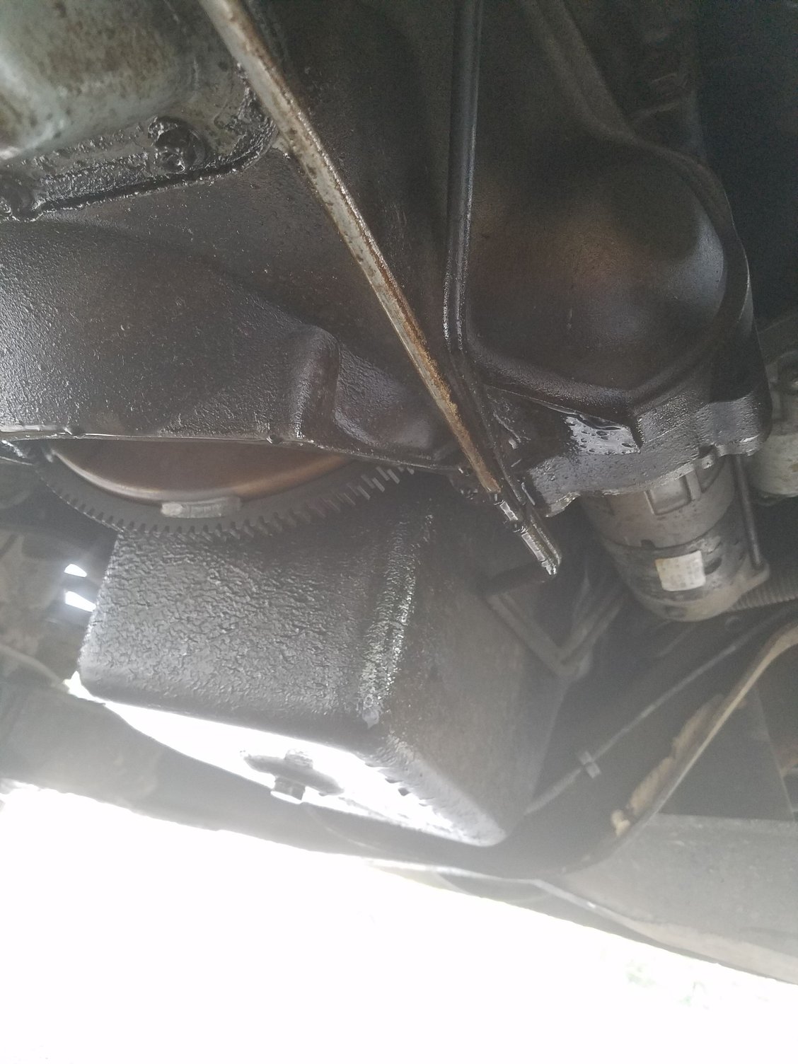

Truck started running really rough, lost power. Pulled over and found oil running out from the area near the inspection plate.. Any ideas!?
To the right of the gear..

Are you sure it's not fuel washing down that side of engine?

Yep, fuel leaks look like oil leaks after the fuel mid s with that thin layer of oil that has accumulated over the years. Pull your air cleaner and look in the valley for a leak. There is a drain in rhe back of the valley pan that dumps at the rear of the engine, right where it meets up with the trans, so it runs down from there.

While there is some fuel in the valley, my dipstick isn't even registering oil.. Any other ideas? I don't see any oil in the valley.

Sorry. Yes I have a turbo. I just got the truck home. Had to put a gallon of oil in it. It was pouring out from the same location again

Does it leak even when the engine is off?
Awhile back I had a rather significant oil leak that would drip down over the starter as well, but it was just the passenger side valve cover that had come loose.

On a side note, please tell me you weren't driving around without a flywheel cover?
That looks more like diesel to me.

Is this the 1997 truck in your profile? It's, er, not an IDI. Best to ask a mod to move this thread.
If you have fuel in the valley and are that low on oil, you're probably leaking both, and they're mixing as they drizzle down, which would explain the appearance.
