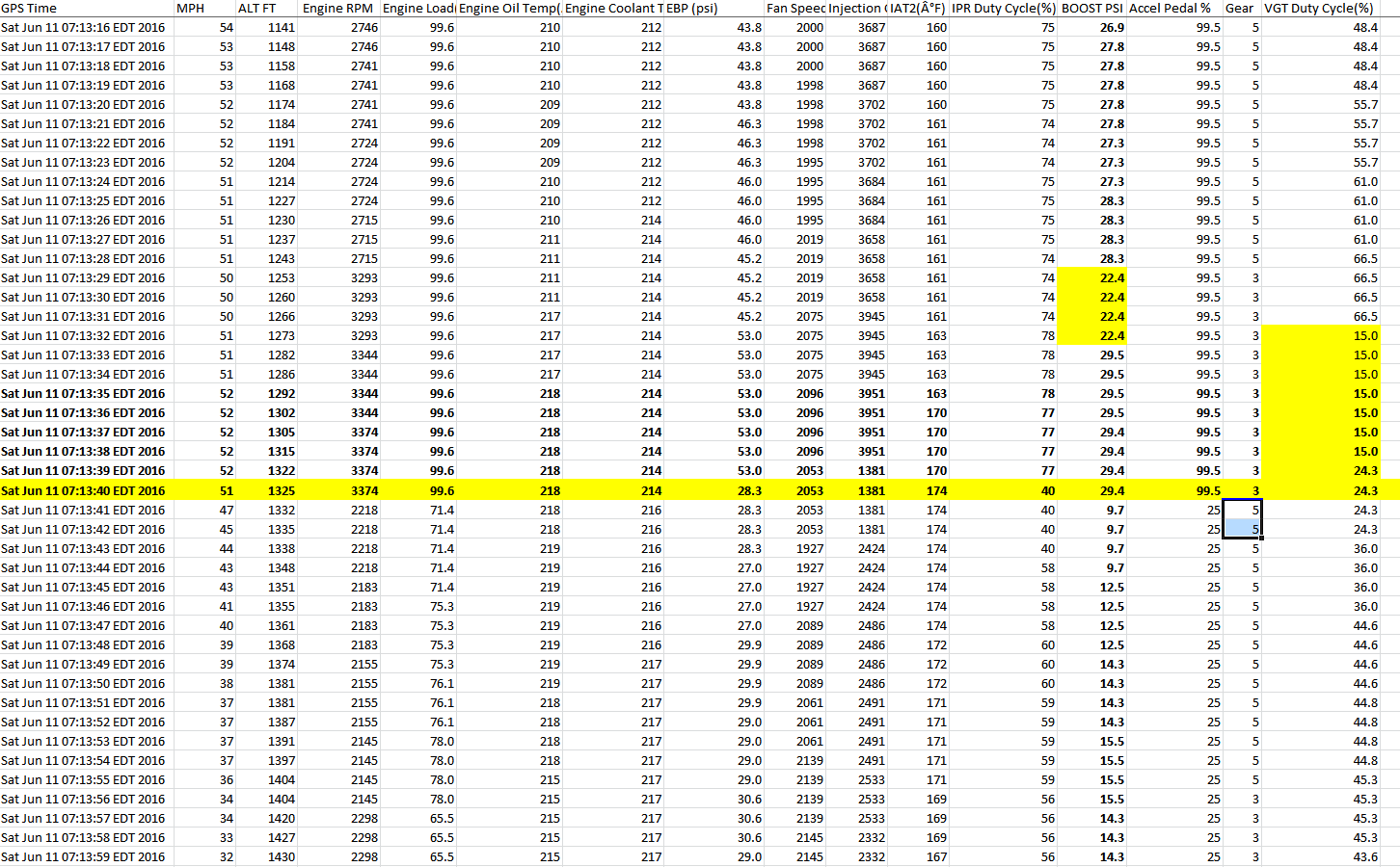

I had an overboost happen to me twice over the weekend, pulling two separate grades an hour apart with a 6000lb trailer at 100% go-pedal and engine load. I was logging data with Torque Pro at the time and see the VGT% went to 15% for 8 seconds and I had 29.5psi for those 8 seconds before the overboost threw a code and put me into limp mode. The log I looked at showed me going 55mph in 3rd gear leading up to the issue, and as soon as the overboost happened, I felt a hard gear shift, which the log shows was a 3-5 shift. I pulled over when I could both times, read the code to see it was overboost, and shut the truck off, restarted it, and it was fine both times.

Here is some of the data from when it happened. I highlighted the row where I think it happened, along with a few other parameters where it did something I don't fully understand. VGT% and boost suddenly went up for 8 seconds leading up to the overboost.

In my opinion, your koeo leads my to believe you are sending the proper signals from your MAP and EBP. You are pulling way too much sustained psi, and your turbo vgt signal is trying to compensate.
Going into limp mode, grunting and groaning, pulling an over or under boost code, all makes me turn towards the turbo ring.
How many miles on the truck?
You're probably flying when you pedal down, thinking all is okay, but you will find it a bit slower after you fix it. But it will pull much better.

the over/under boost wrench is from that condition occurring for more than 5 seconds and/or for 4lbs or more during the time period.
At 17:13:32 it commanded 15%, which is full boost and it answered 1 second later. Looks like it held that boost for 6 seconds and commanded the gear change. At 13:38 the RPM dropped... ICP went from 3951 to 1381.
I'd say it stuck because it took an extreme VGT movement to get motion.
