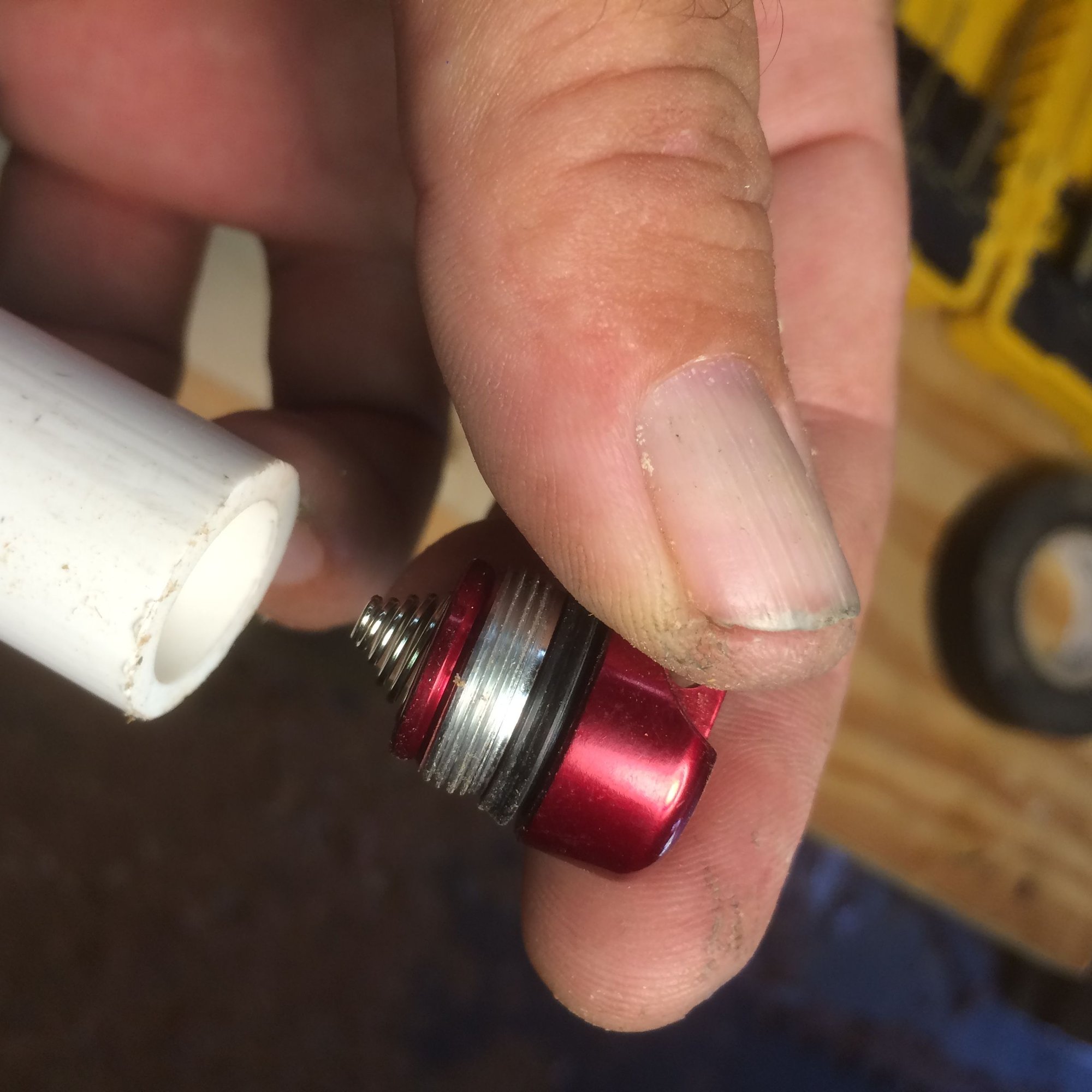

Back side of probe, showing twisted junctions.
There's a hole drilled through the stick. The wire passes through the hole and around the end of the stick in extremely-fine saw-cuts in the end to positively locate the wire.
Front of probe. This side will be presented to the fuel injector terminals.
The butt-end of a 2-AA Mag-Lite will cut its own threads into the inside of a piece of 1/2" PVC pipe.
I tested continuity through the anodized finish on the cap, and found that the coating is non-conductive, so I abraded the surface around the lanyard hole to ensure reliable electrical contact for the twisted wire junction.

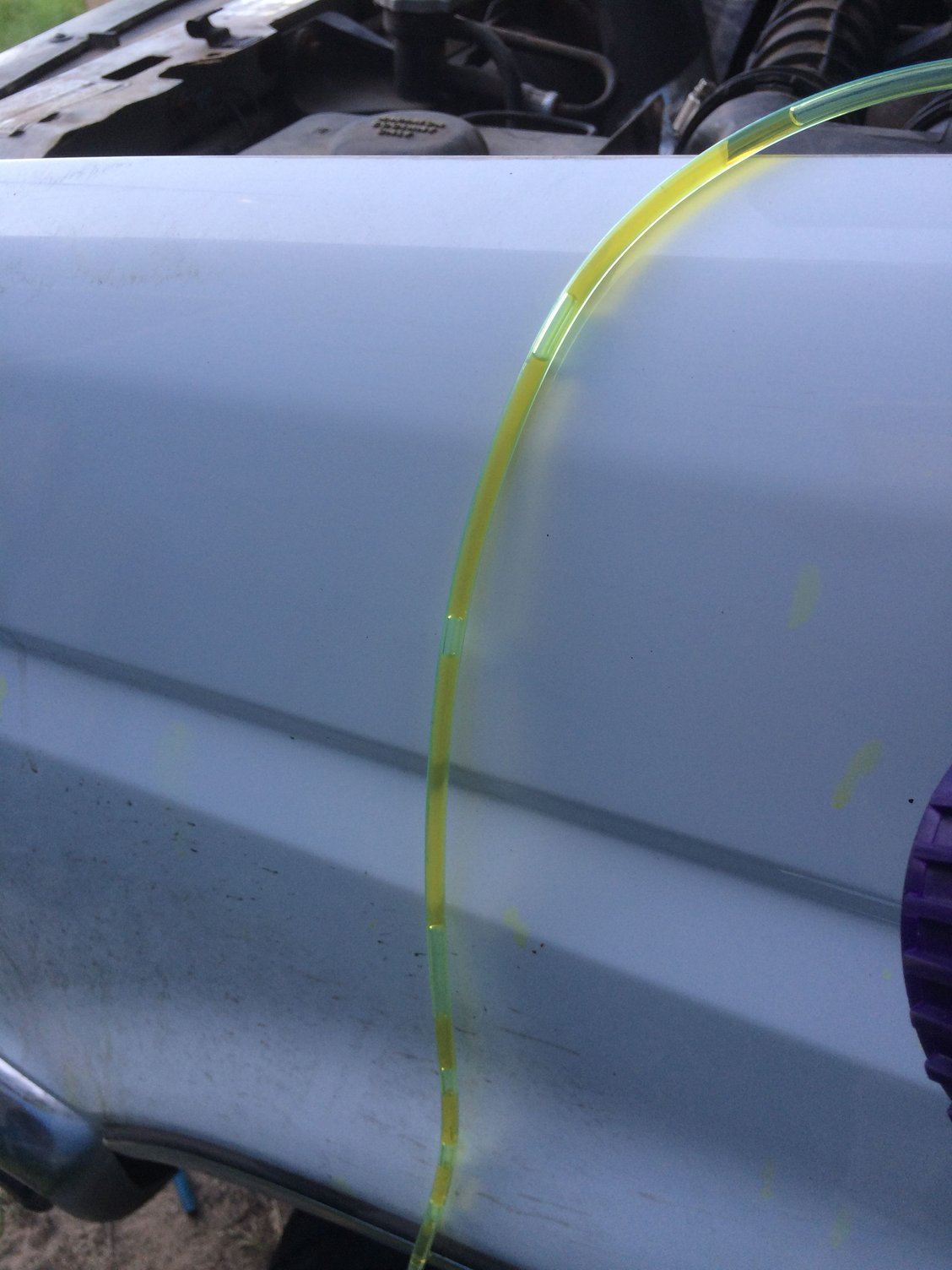

When I bled the gauge through the little clear tube, the gas that came through there was as yellow as urine.
Anybody know what gives?
Old Jul 8, 2016 | 08:08 PM
  #45
woodjunkie's Avatar
woodjunkie
Joined: Jun 2016
Posts: 54
I don't think gas is supposed to be that color.
