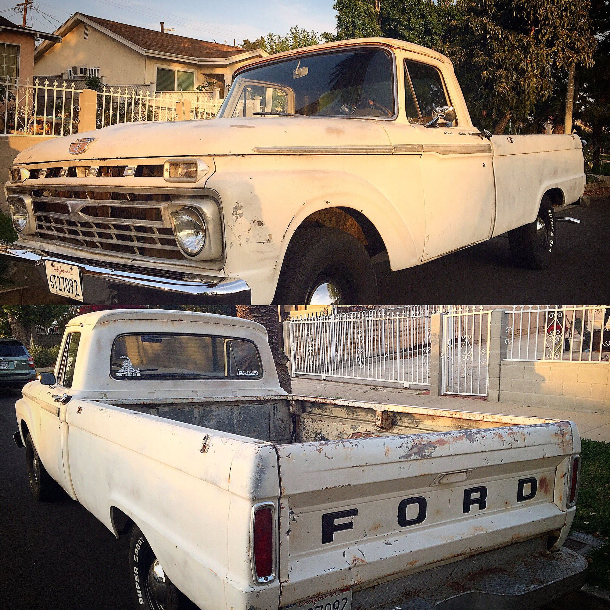

I'm at a loss... 1966' F100 352 2brl.... I have installed 3 distributors so far, all of them have stopped sending signals to my coil... 2 of them where drop in flamethrower II. I do have a matching wires and coil. Running E3 plugs... Truck runs amazing then out of no where it takes a horable turn..... Starts dropping cylinders and has no power, backfires and sputters.... I have replaced all my power cables and everything is isolated and I have 2 grounds on the truck. No one has any ideas I am hoping you guys may have the answer to what I missed.... I even jumped the battery to the coil and it's still hit or miss. Any help would be great.....
