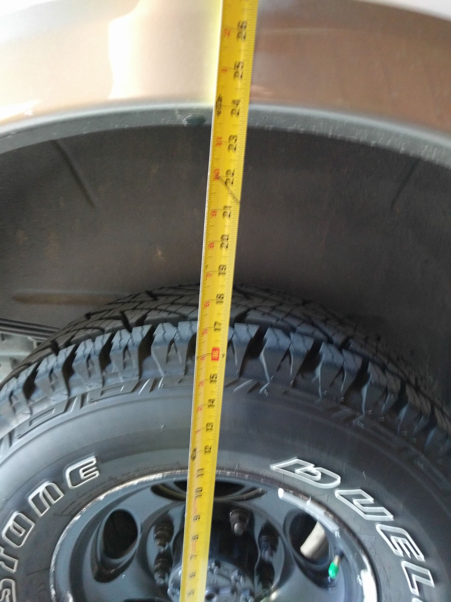

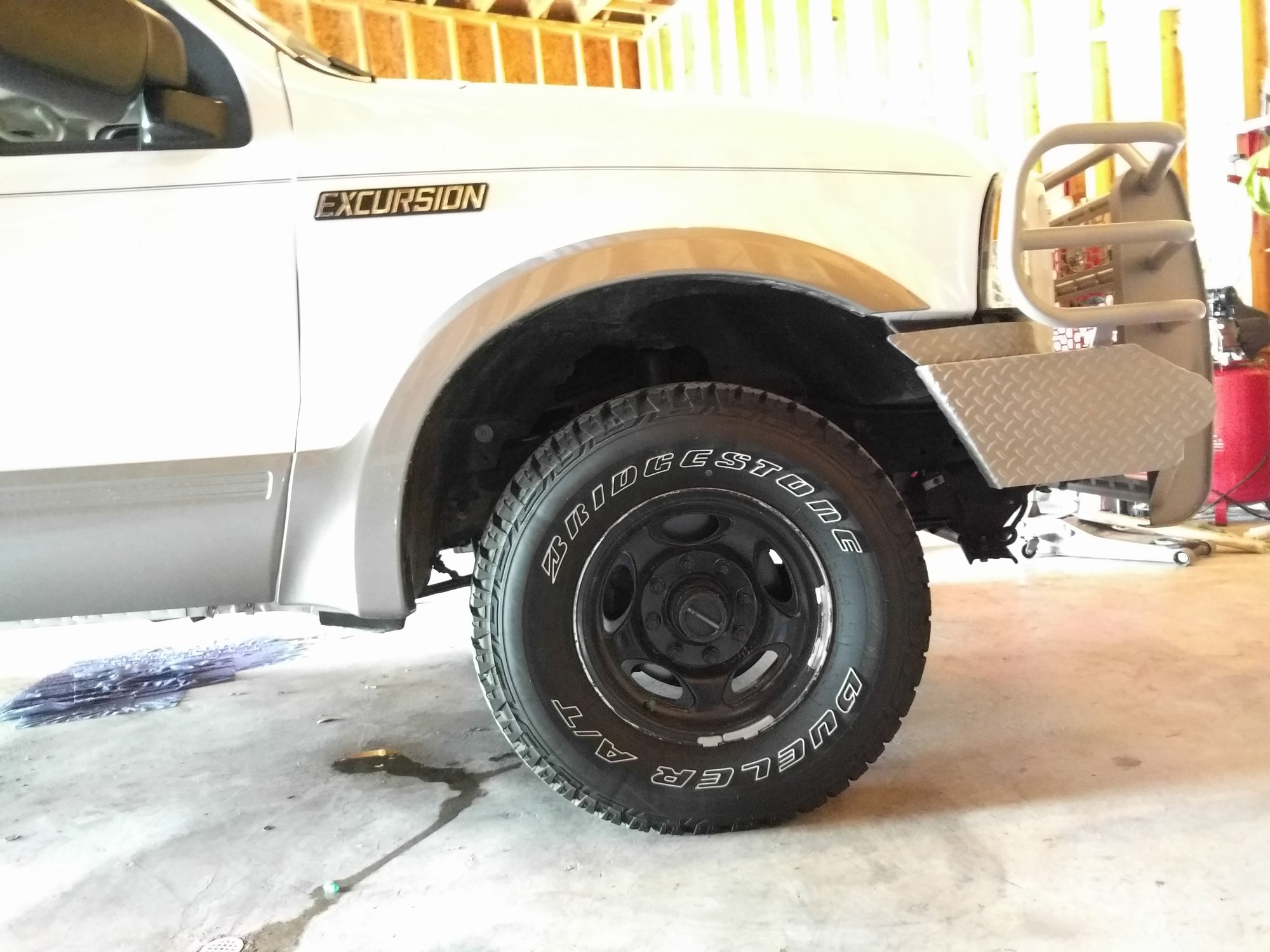

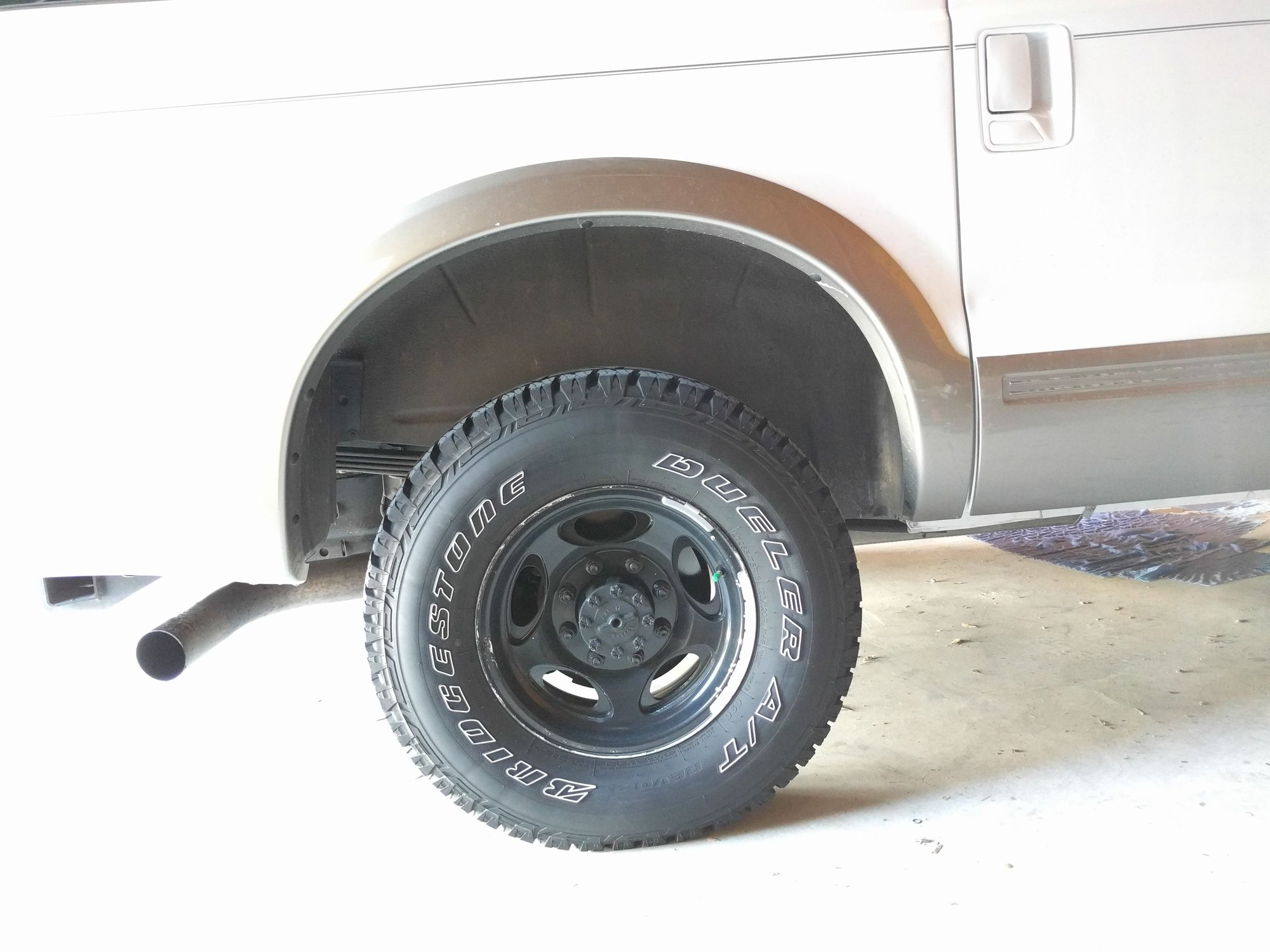

Well I woke up this morning not feeling very well so I moved pretty slow. Doesn't help that it's damn hot outside.
Here's a couple of before shots. Measurements are from the center of the wheel.
Clearance to bump stop. Couldn't take a pic with the tape in there because the tape is all you'd see from the camera flash. Looks like 1.5 fingers = 1 1/8th inches.
Front driver's side
Rear driver's side
Front passenger's side
Rear passenger's side
Front springs are in. No measurements yet, wouldn't mean anything without the rears done.
Maybe more tomorrow!
