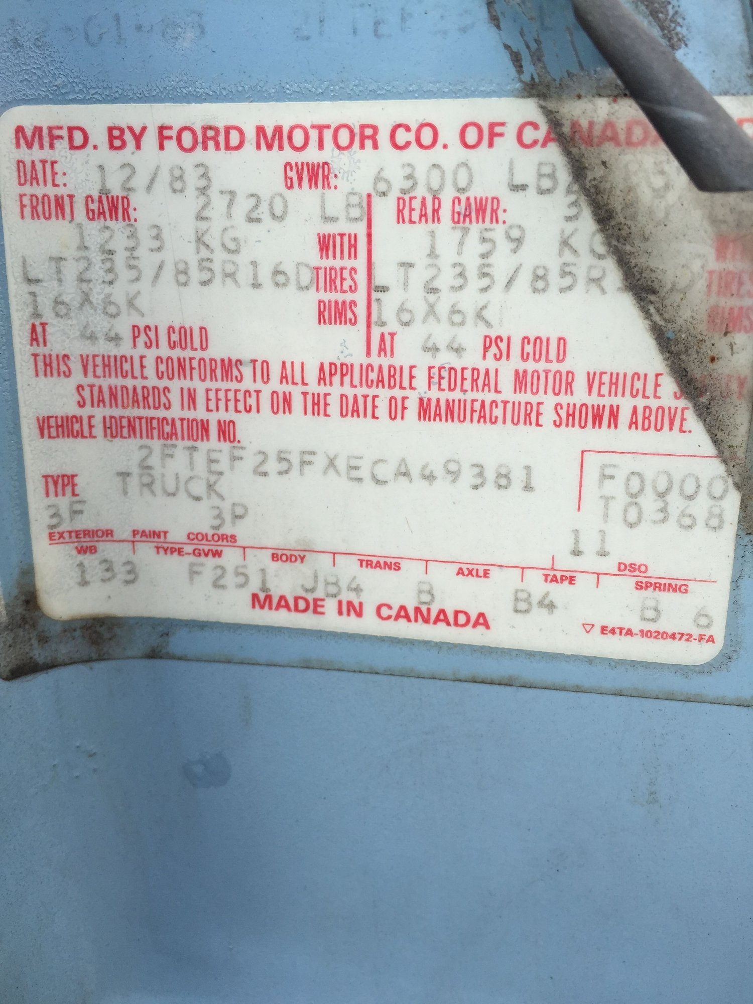

My shifter does not say OD. I also see that those calibration codes are for 4WD but I double checked and they are the same for the 4- 2WD ones I posted. I took them off of the very first image you posted on this thread "model application to parts list cross reference".
Here's a shot of the label.

The "B" between TRANS and AXLE says you have a 4-speed OverDrive tranny made by Clark - as shown here: Transmission Codes - ???Gary's Garagemahal.
And, as luck would have it, one of the two codes you gave (4-53L-R10 & 4-53L-R11) is the right one for your truck, although we won't know which one for sure. However, both use carb E4TE-AMA and component list 95.2AK. And, that's the info I posted on the previous page as using jets 51F. And, the way I read the catalog, your carb should take the same power valve as Rick's carb - the CE-132.
