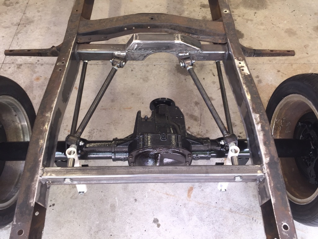

Made some good progress over last few weeks and now have the frame down on its wheels!! Scotts IRS front end and welder series triangulated 4 link out back with front/rear sway bars. Rear 4 link has frame rails boxed and additional boxing to be done later.
Hopefully this weekend I will get the engine/AOD positioned and mounts done.
Progress is a good thing...

Looks pretty good, what do you have for wheels and tires, what back spacing on the rims?

The wheels are temporary, Craigslist 'specials' just to get me rolling. I'll be able to use them to determine what I need for the final wheels.
