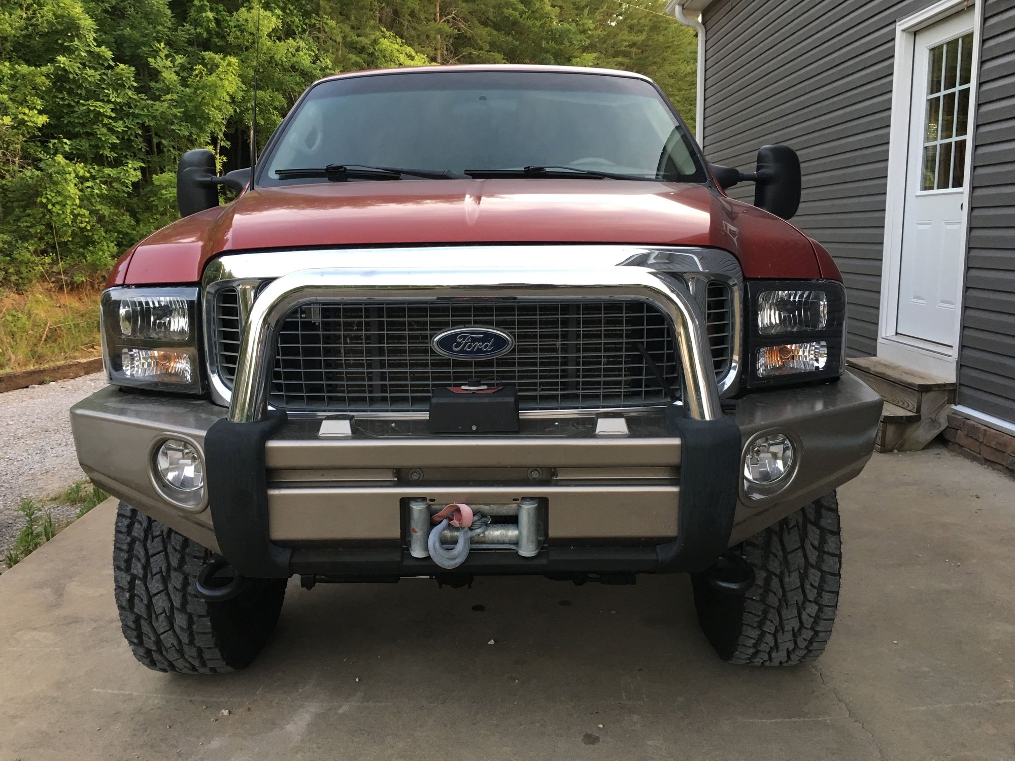

So, this new to me Excursion came with a cool winch bumper complete with winch and integrated fog lights. Now, if you were a fog light switch, where would you be hiding?
Well, first off this is a 2001 Excursion and it did not come with the factory fog lights which means no pull out headlight switch.
Next, there are no aftermarket switches anywhere on the dash
Finally, I see wires leaving the lights but where they go I have not been able to trace them.
So, if you wanted to install aftermarket fog lights and hide the switch, where would you put it?
Bumper lights.......
Another angle......

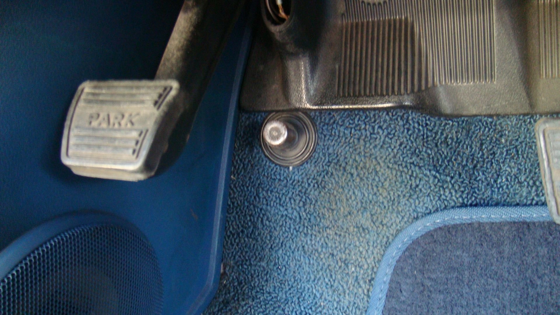

is there a foot switch? BTW, great looking Ex! Nice and clean!
Old May 24, 2016 | 12:06 AM
Stewart_H's Avatar
Stewart_H
Joined: May 2004
Posts: 29,380
Likes: 118
From: Central Coast of CA
Old school high beam switch for the win!!

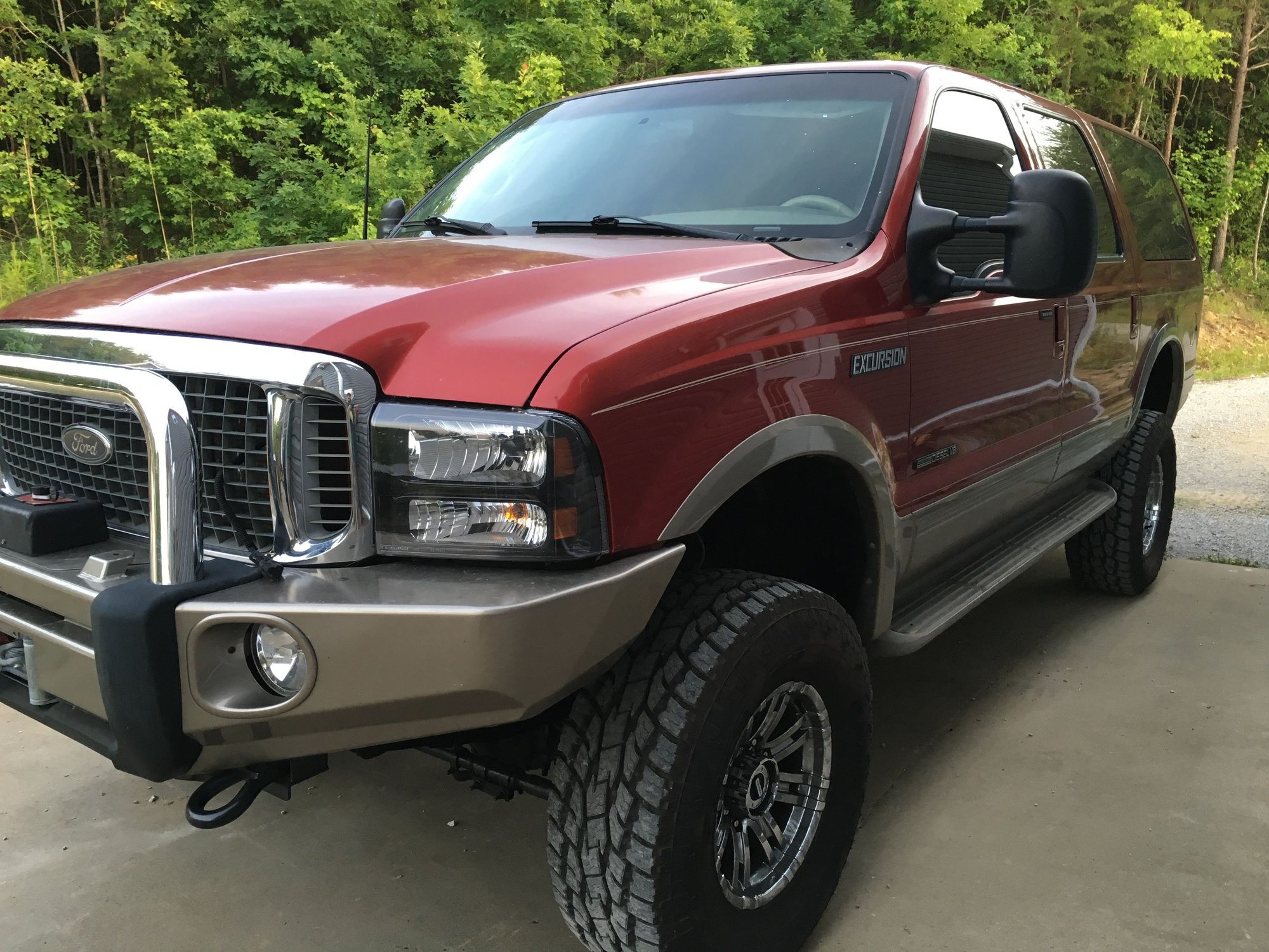

Thought I would throw in one last pic.
I guess I will plan on wiring the fog lights in since I can't find a switch for the anywhere. I might try the factory fog light switch since the current (non fog) switch is really worn and the **** is pretty loose.
