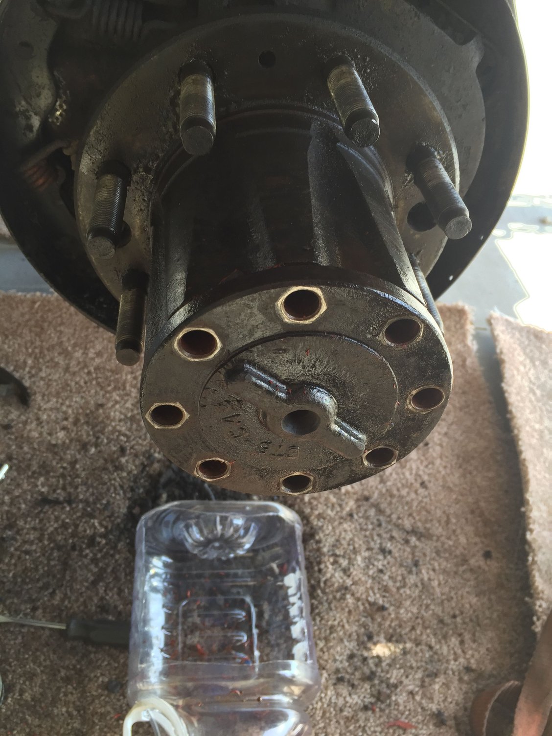

I have a question I have a 86 f250 7.5 xl 4x4
I'm trying to take out my axle shaft
Rare end 10.25 I removed the 8 bolts now what do I to remover the shaft out
Thanks for the help

It should pull out. There is a gasket between axle shaft & wheel hub and it has to be holding it.
Use a dead blow hammer and give it a few whacks.
Dave ----
Thanks for the tip
