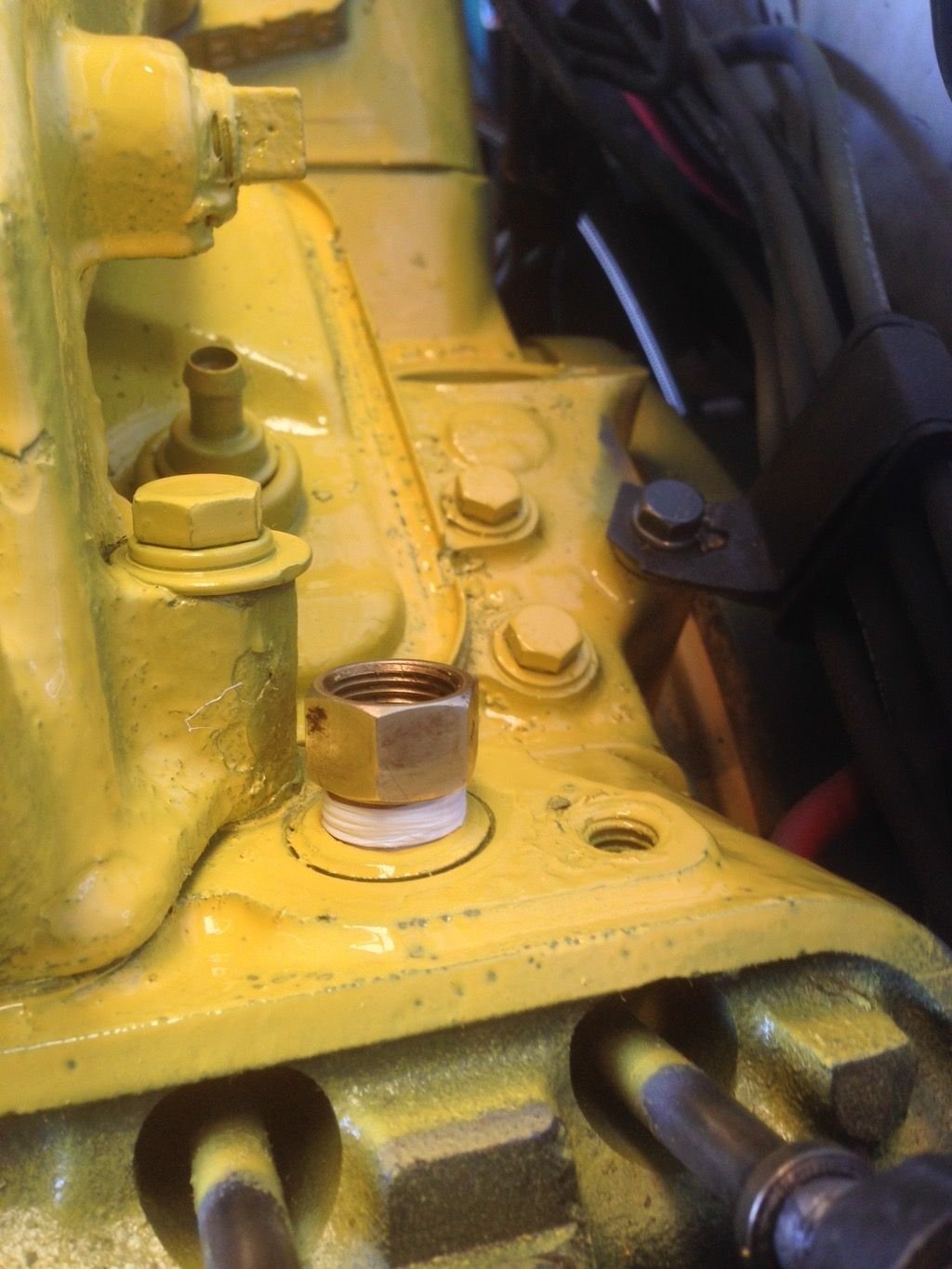

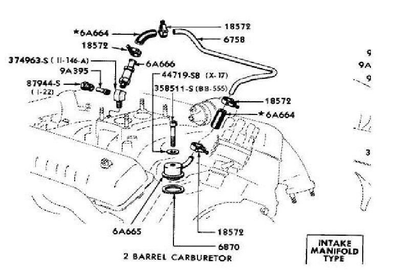

There is a factory baffle below the PCV. I just installed a PCV in the hole that use to have a dump tube in it.
This is how it was originally.
Here's mine.

That vacant bolt hole in the head, just to the rear of the brass fitting is sometimes overlooked during final assembly. Left open, they will throw oil out at speed . Possibly affect crankcase vacuum as well.

Thanks for the observation Ray, that picture was taken during assembly. It is were I attach an engine to cab ground & a short bolt so it doesn't bottom out and hit the pushrod. Also the spark plug wire loom is turned upside down in that picture. AND The larger hole on the opposite side now has the distributor in it.
