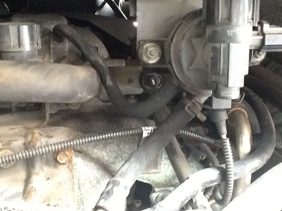

Here is a pic with the dog house removed. Can you suggest area to look for PCV?
I tested EGR valve by sucking and it stalls out so that means that's not the issue. There is another similar looking unit with large vacuum off the intake manifold. That one has vacuum at idle. What is this!

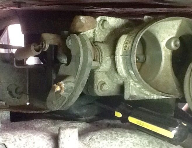

After removing all the air intake system I was able to see into the front underside of the throttle assembly. And there it was.
A big slit in the vacuum line to the PCV just as JWA said it would be.
You can see it with the screwdriver stuck through.

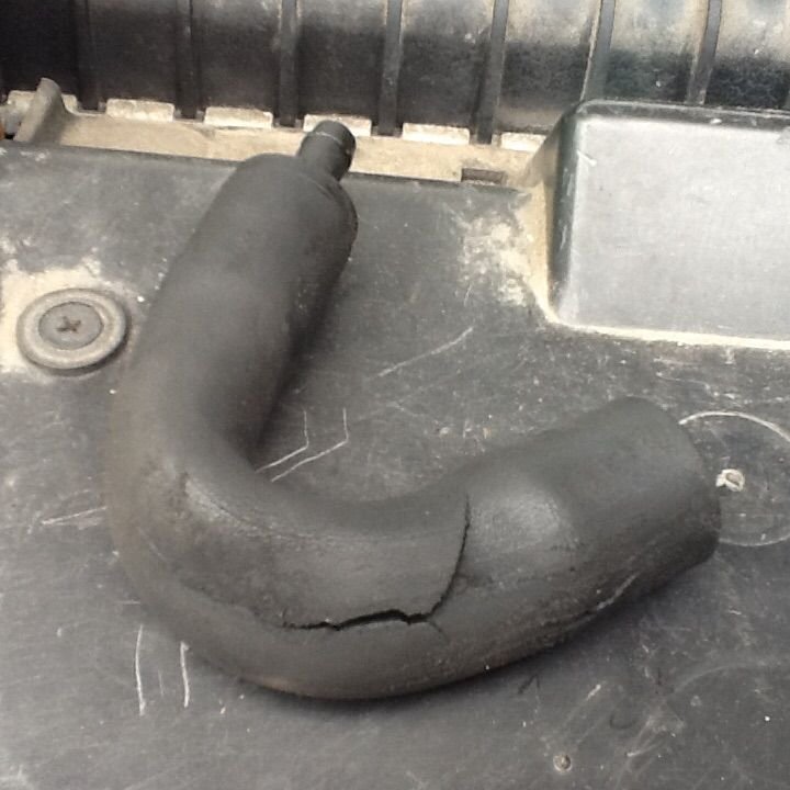

Here is that bad boy
Auto store had an aftermarket replacement of exact size on each end for $12.50 so I'm back on the road.
