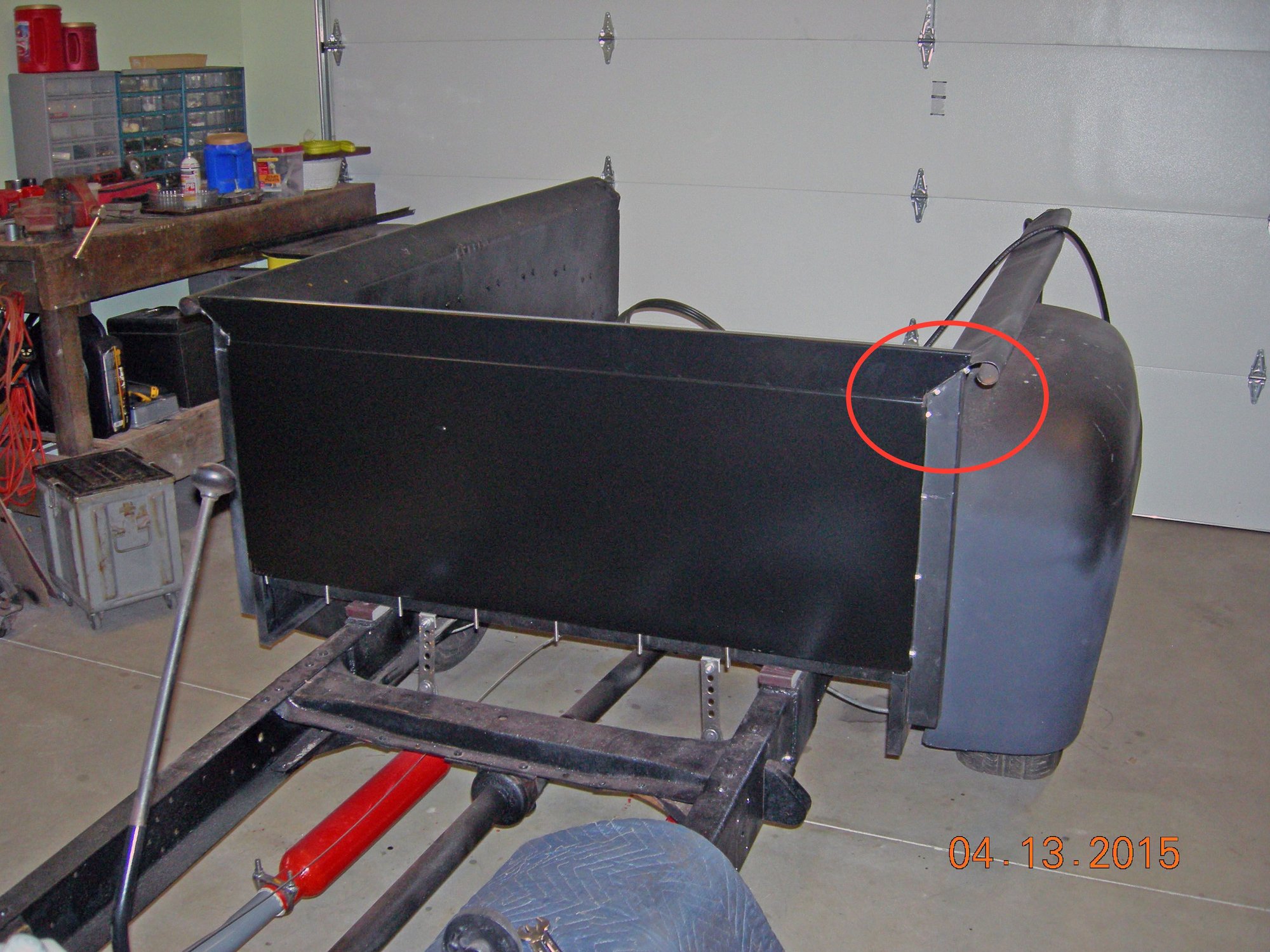

Bed rail angel
Im getting ready to build my own custom bed. What is the angel at at the top of the bed where it rolls over. The best I can tell it is 47.5 degrees. If anyone has a degree finder handy and could go set it on there bed I would greatly appreciate it.

Rough sketch of the area I'm talking about.

I have a digital ANGLE gauge and made numerous readings on a bed I have here in the shop...readings range from 48.5 to just shy of 50 degrees.
Your 47.5 measurement should be just fine...no rocket science in this dimension, even where the top flange bolts to the header panel is not critical since the bed side will bend to match the angle on the header panel.

Using the old eyeball and protractor method, I've got just shy of 48° on one side of the bed and a hair over 49° on the other, both dimensions on the tailgate end.
Like CharlieLed said, the angle doesn't need to be exact...especially if you're bending up all your own panels to fit.

Bed sides on both '52 trucks are from Northern Classics . Both measured 41.5 degrees.

The best place to measure is at the front panel where the side meets the front panel.

Measured in described spot near front panel 40.4 degrees .
