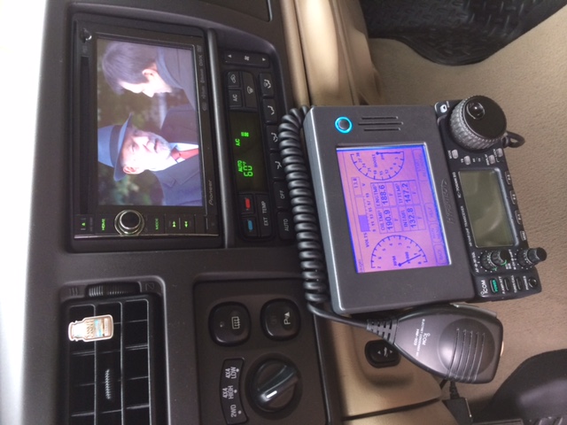

I used a remote cable with my icom and had a custom bracket made that came out of the cubby hole. Main unit was installed in center console.

That's a good idea for the remote face, The one I'm looking to mount is a KENWOOD TK-981 that is a little heavier. Looks like i'm going to have to build something custom as well

I used a mag mount that sat center of rear ( by the third brake light ) so I only had a couple of inches of cable exposed. This setup worked very well with very low swr's and was able to talk all over the world with just 100 watts.
