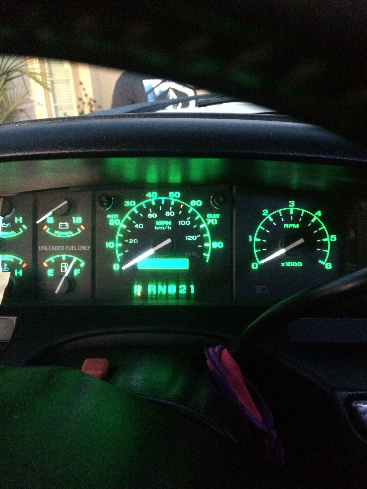

Put some LEDs in there. Dash takes 5 and hvac takes 2 to match. These have white leds. I bought cheap ones on eBay and they kept going out. Then bought some from
superbrightleds.com and been good for a year now. Name:  photo576.jpg
Size:  2.10 MBName:  photo216.jpg
