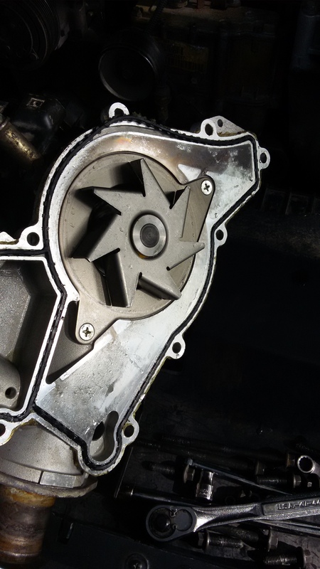

Well, still didnt get to do the radiator swap, wanted to further troubleshoot. So as some have suggested yesterday I removed the thermostat and extended the top radiator hose past the front grill with some pvc pipe. With the system full of coolant, I cranked the engine and there was no pumping action at all. Nothing coming out of end of pipe. Rev the engine, nothing. Kill it. Okay, now i know the issue is water pump related (new pump, but two years on shelf). My neighbor thought it might have had a mouse either make a nest or die in one of the passages of the pump and plugging it up (happened to him once on a tractor water pump). Well then i pressurized the system by placing my mouth on the degas bottle cap and blowing...Big ole fat stream of water exiting the pipe. Okay, its not pluggage. Must be a broken pump shaft or spun impeller, never seen that before, but only logical choice left.
Today I called Ford and ordered another water pump ($300, use OEM parts to rule out anomalies). I get home and start ripping into the water pump again. Upon removal from the engine..... low and behold.....the culprit appears plain as day.....
See anything wrong with this picture?

The ring around the impeller must have been some sort of shipping/protector sleeve that I just did not notice when installing the pump the first time... DOH!!!! I feel so foolish...

There was just enough space around the edges of the ring and pump volute to allow the coolant to thermally cycle on heat convection alone or maybe it acted a bit like a peristaltic pump, who knows.

So, I remove the ring, reinstall the pump, and go for a test drive. Voila!! Over heat problem solved!! No more head scratching anymore. I ran the dog snot out of it on the same route as before and nothing more than normal temps on the gauge and the temp gun (no picture though). And the heater now works. Eureka!!! I just NEVER noticed that damn little sleeve the first go round. Going from my memory, it magically appeared because I didnt see it the first time, but I know now it was there all along. Just a simple oversight that could have burnt up my engine and caused my headaches to be alot worse (fingers crossed). I feel foolish that I did not catch that on original install.... brain farts will get the best of ya....
