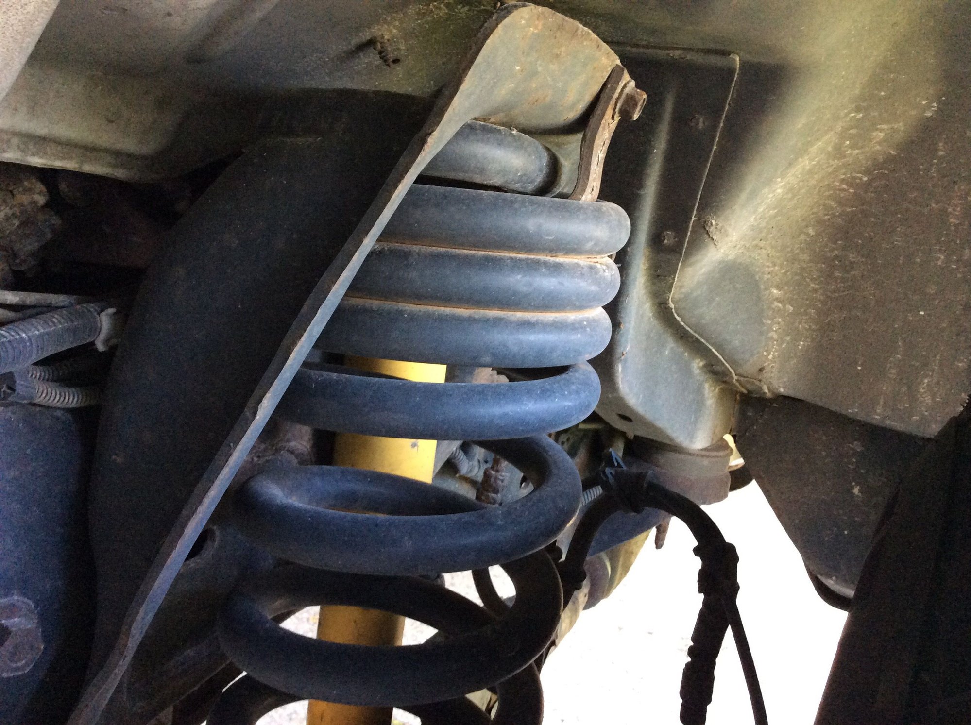

So, here's my new (installed 12,000 miles ago) coil springs.
Watched a YouTube mechanic say this was a problem- how the top twist is basically touching each other
