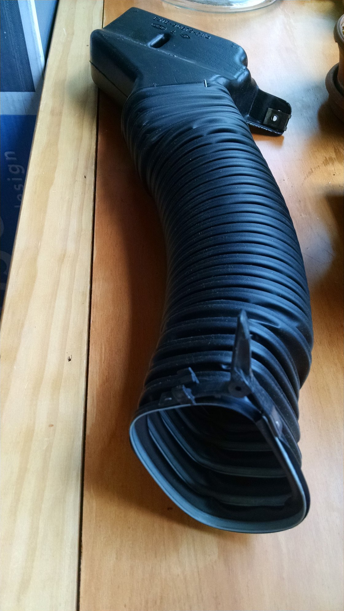

I have one of thoses plastic snorkel boots as well as the one on my truck. Customer truck that we pulled the oem 302 out of for a 5.0 coyote engine I gutted what was not needed and kept what was worth keeping.
I just didn't get the aircleaner which was mint and not split like mine cause boss grabbed it for another customers truck.
