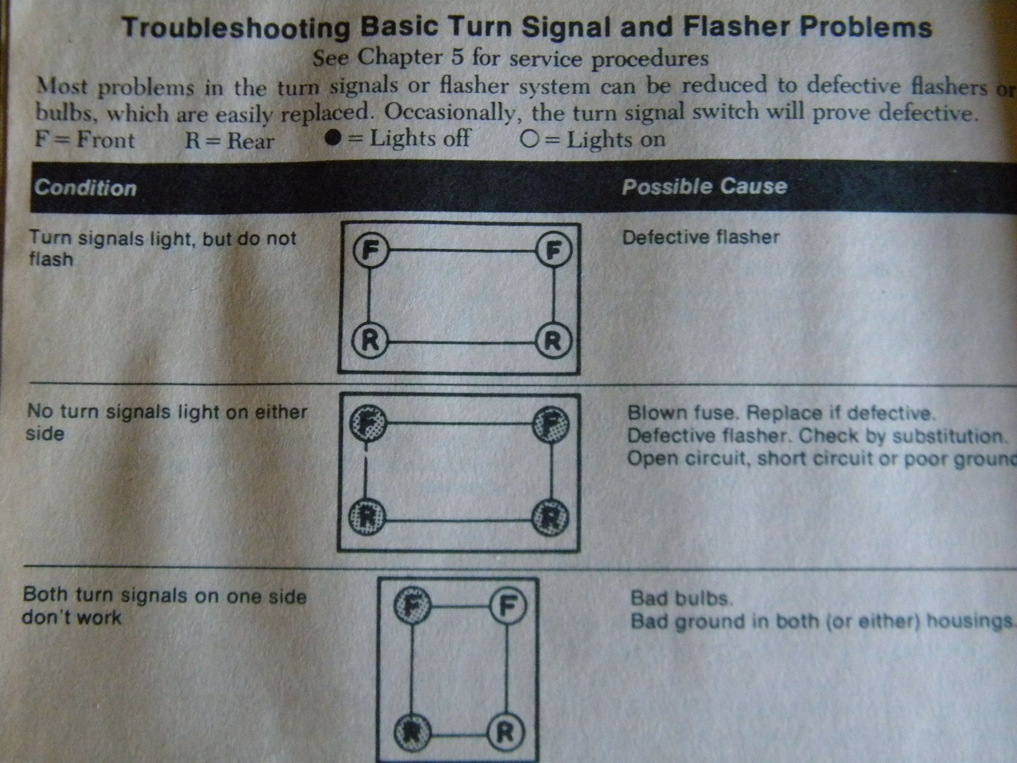

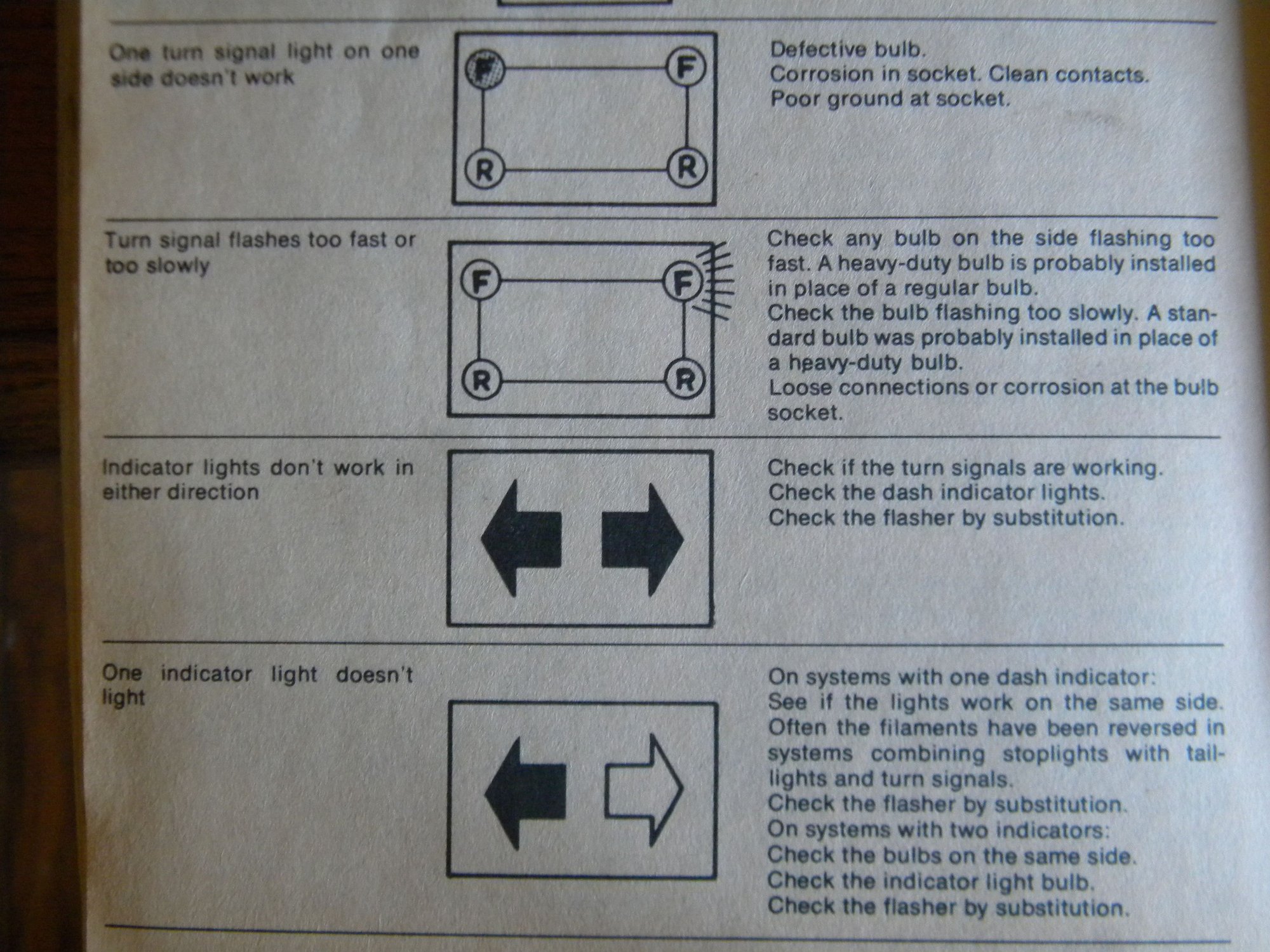

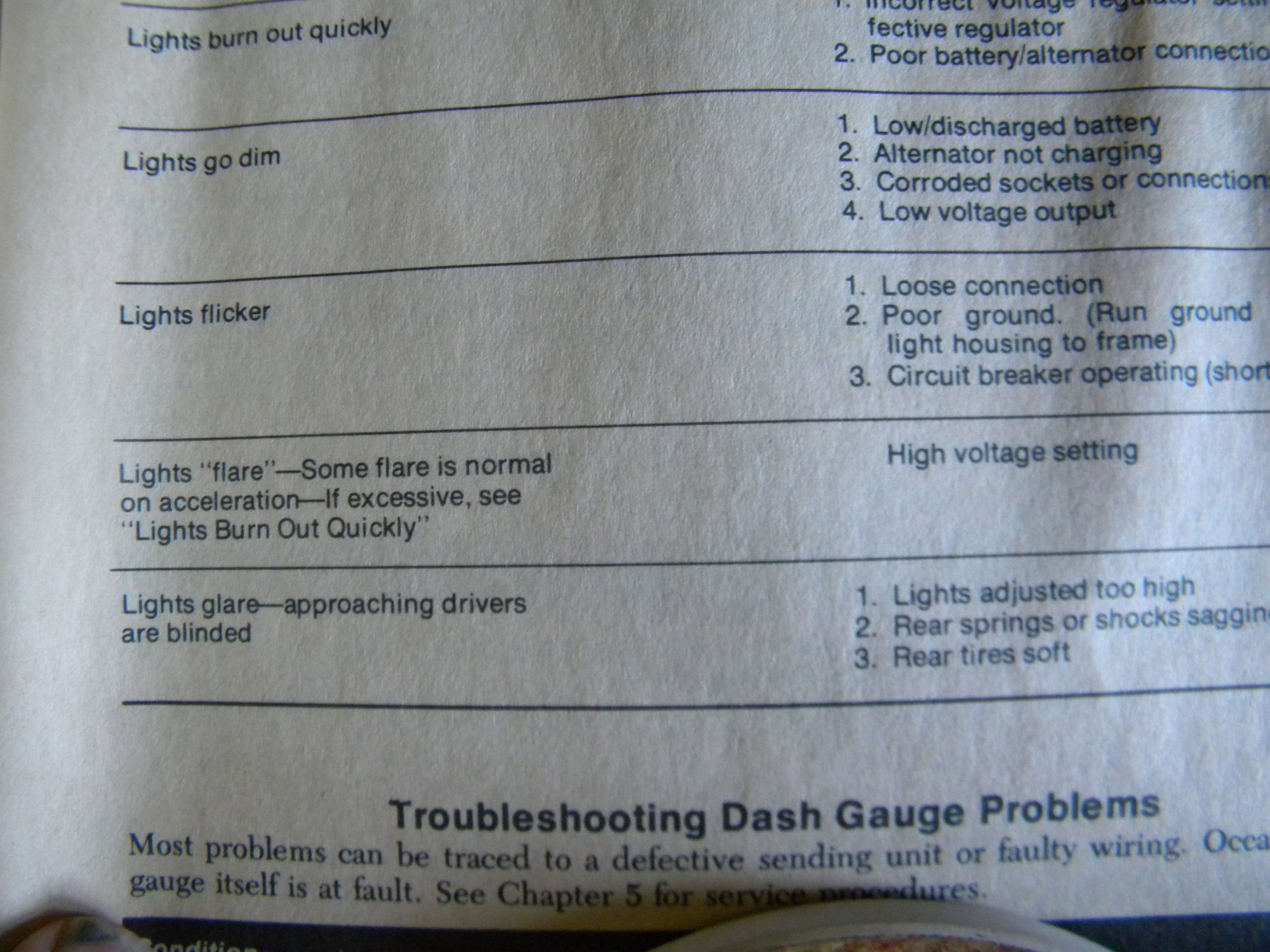

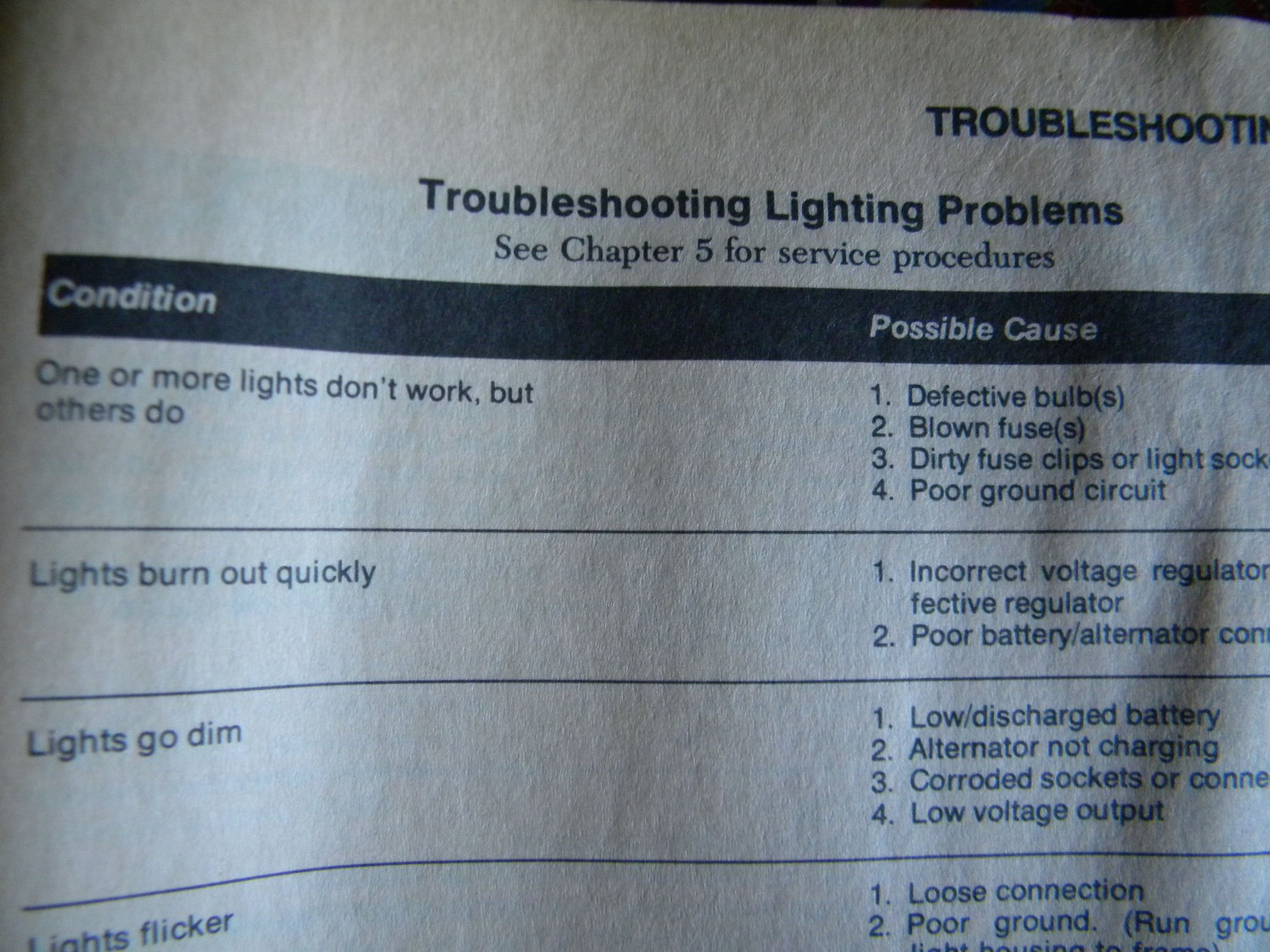

is yours and your dads light switch possibly dirty?
(i.e. dust and grime build up between posts)
have you tried replacing the turn signal switch?
or checking for a short in the steering column wiring?
or how about both relays under the dash?
is your ignition switch sticking in between the start and run position?
are you trying to use after market "brighter" bulbs?
Is it just your fronts that keep blowing? maybe you have a bad wire or ground at a rear or side light.
